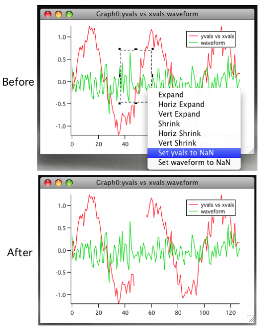

Set Values in Marquee to NaN
// https://www.wavemetrics.com/code-snippet/set-values-marquee-nan
// Written 2009-07-23 by Jim Prouty
// Edited 2015-11-06 by Joel Corbin
// Revised 2018-07-19 by Jim Prouty, version 3, added undo, added ActiveGraphWindow() to support subwindows. Omits bar chart traces.
// Adds one menu item per trace to the GraphMarquee menu.
// Selecting one sets only that trace's values which lie inside the marquee to NaN.
// Both Y vs X and waveform traces are supported.
// One-level undo is implemented.
#pragma rtGlobals=1
#pragma version=3 // 2018-07-19, JP
Menu "GraphMarquee", dynamic
	Submenu "Set y-axis data within marquee to NaN..."
		CommandPerTrace(), /Q, SetMarqueedValuesToNaN()
		CommandUndoTrace(), /Q, UndoSetValuesToNaN()

MGHuber
Great Code. The only thing I would note is that to get it to work with subwindows graphs
change
	String graphName=WinName(0,1)
to
	GetMarquee
	String graphName= S_marqueeWin
