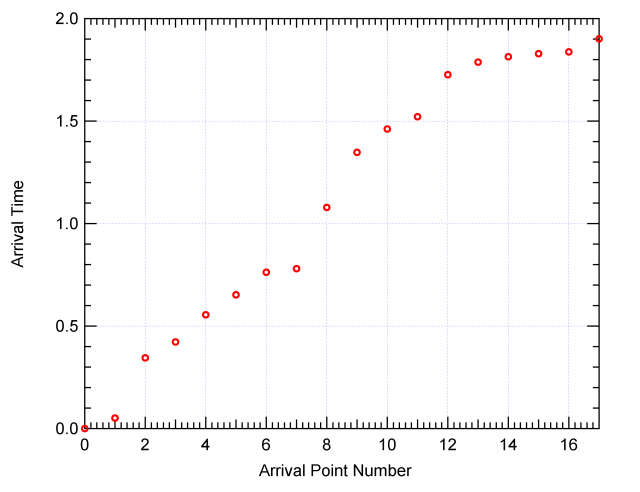

Function/WAVE fPoissonArrival(interval, lambda) // cumulative Poisson Arrival times in "wArrTime" variable interval, lambda // interval = counting interval; lambda = arrival rate/unit time make/O/N=1 wArrTime // this will contain the cumulative arrival times wArrTime[0] = 0 variable i = 0 Do i+=1 InsertPoints i+1, 1, wArrTime wArrTime[i] = wArrTime[i-1] + expnoise(1/lambda) // independent arrival increments are exponentially distributed While( wArrTime[i] < interval ) // stop after interval exceeded DeletePoints i, 1, wArrTime // delete last point, which is outside interval wave wout = wArrTime Return wout End
Attached is a graph of a typical output; Tests of repeated trials showed excellent agreement with the exact Poisson count distribution.
With recent improvements to Igor, this function returns a WAVE reference to the output. In your user function, it is used as:
WAVE wout = fPoissonArrival(interval, lambda)
I chose to use a simple, if inefficient, method for adding sequential arrival times. Using a pre-sized Igor wave might sometimes be quicker, but would ultimately require end-point checking, and either truncation or point addition since the 'a priori' number of arrivals is unknown.
