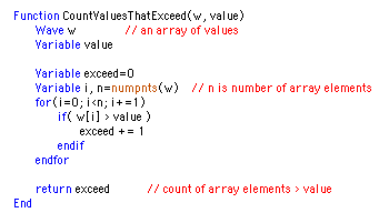

Here's a simple function that counts the number of data values that exceed a given number:
Local and Global Variables
Like nearly every other procedural language, Igor´s language supports local (or "stack") variables (and strings and structures) that vanish when the routine containing them ceases execution.
In the example above the parameters w and value and the local variables exceed, i, and n exist only while the CountValuesThatExceed function is running. Afterwards only the returned value exists, either in the calling routine or in a global if assigned there. For example:
Variable/G gCount= CountValuesThatExceed(wave0,100)
creates a global variable gCount whose value is the returned exceed value. gCount will continue to exist after the end of command execution, and can be observed in Igor´s Data Browser.

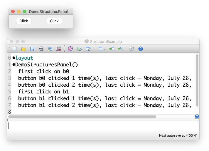

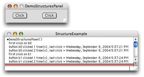

You can define your own structures and pass them between functions. The syntax for using structure members is similar to C. Structures can contain numbers, strings, arrays of characters and substructures. In addition, Igor has some pre-defined structures such as the WMButtonAction in this simple coding example which also demonstrates that Igor´s structures can be converted into and from strings:
// A window proc that creates a user-defined panel // with two buttons named b0 and b1. Window DemoStructuresPanel() : Panel PauseUpdate; Silent 1 // building window... NewPanel /W=(343,91,561,138) Button b0,pos={26,12},size={50,20},proc=ButtonProc,title="Click" Button b1,pos={130,12},size={50,20},proc=ButtonProc,title="Click" EndMacro // Defines a custom structure Structure mystruct Int32 nclicks double lastTime EndStructure // The function which runs when Button b0 or b1 are clicked. Function ButtonProc(bStruct) : ButtonControl STRUCT WMButtonAction &bStruct // Igor-defined structure, passed by reference. if( bStruct.eventCode != 1 ) return 0 // we only handle mouse down (code=1) endif STRUCT mystruct s1 // local user-defined structure if( strlen(bStruct.userdata) == 0 ) // button hasn't had userdata initialized print "first click on " + bStruct.ctrlName else // button has a structure packed into its userdata. StructGet/S s1,bStruct.userdata // unpack structure from userdata string. Variable lastTime= s1.lastTime // get a value from the structure. String ctime= Secs2Date(lastTime, 1 )+" "+Secs2Time(lastTime,1) printf "button %s clicked %d time(s), last click = %s\r",bStruct.ctrlName,s1.nclicks,ctime endif s1.nclicks += 1 // update the structure members s1.lastTime= datetime // seconds since Jan 1, 1904. StructPut/S s1,bStruct.userdata // pack structure s1 into string inside struct bStruct. return 0 End
And this is the resulting user interface:

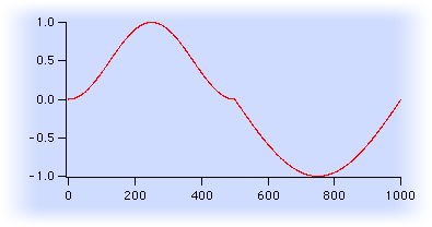

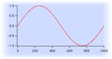

Make/O/N=1000 data // a vector ("wave") to hold 1000 values. data = sin(2*pi*p/1000) // assigns to each element of data. p iterates from 0 to 999. Display data
Here's an example of changing only a portion of the array:
data[0,499] = data[p]*data[p] // replace first 500 values with sqrt(value).
For more examples, see Data Math.

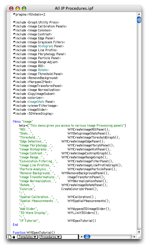

#include
Igor encourages code reuse through its "include" mechanism, which is similar to C.
For example, by simply entering this statement in any procedure window:

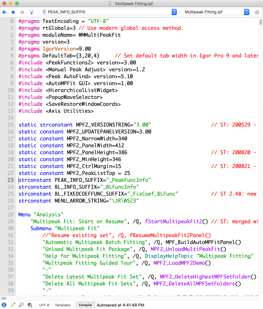

#include <Multipeak Fitting>
Igor adds the Multipeak Fitting package to your Igor experiment:
The package is comprised of multiple pre-written procedure files stored in the WaveMetrics Procedures folder that ships with Igor. The Multipeak Fitting.ipf procedure file itself includes other procedure files that support its functionality:
You can reuse your own procedures this way, though with a slightly different syntax:
#include "MyProcedureFile"
which loads the procedure file named "MyProcedureFile.ipf" from your "User Procedures" folder (which is located inside your Documents\WaveMetrics\Igor Pro User Files folder).

You can add to Igor´s menus by writing menu definitions in procedure windows. For an example, see the "Analysis" menu definition in the Multipeak Fitting.ipf file shown above.

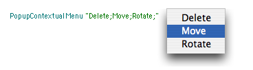

You can also programmatically add contextual menus to graph, table, panel, and layout windows using the PopupContextualMenu operation or add menu items to many of Igor's built-in contextual menus.
