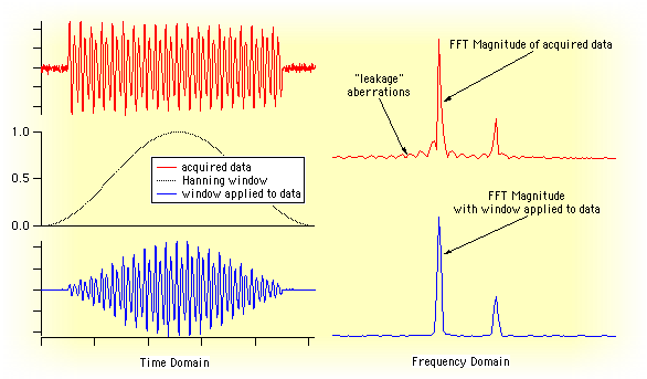

Windowing premultiplies input data supplied to the FFT with a value that smoothly decreases to zero at each end of data.
The purpose is to reduce "leakage" aberrations in the FFT output that are introduced by sudden changes in the data at the start and end of data. Much research has been applied to the selection of the proper "windowing function", so Igor Pro®´s FFT supplies many of them:

Here is a demonstration of how windowing can improve the Fourier Transform result:
