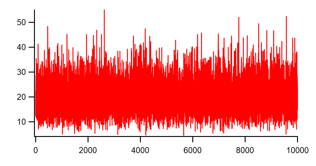

You can easily verify that the various noise functions indeed generate the desired distribution. For example, suppose you generated 10000 data points from a Gamma distribution as in:

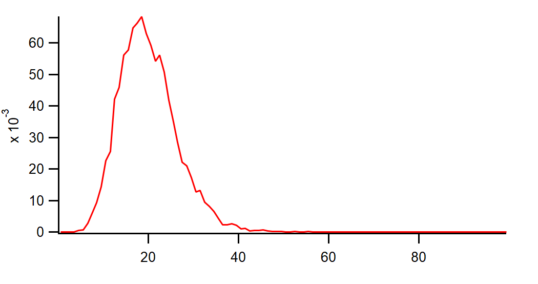

Histogram/P/B={0,1,100} noiseWave,W_Hist

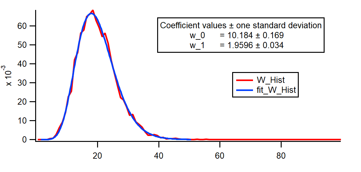

FuncFit/NTHR=0/TBOX=768 myFit W_coef W_Hist[1,50] /D
The resulting fit to a Gamma distribution is drawn below in blue plotted over the calculated distribution (red).
