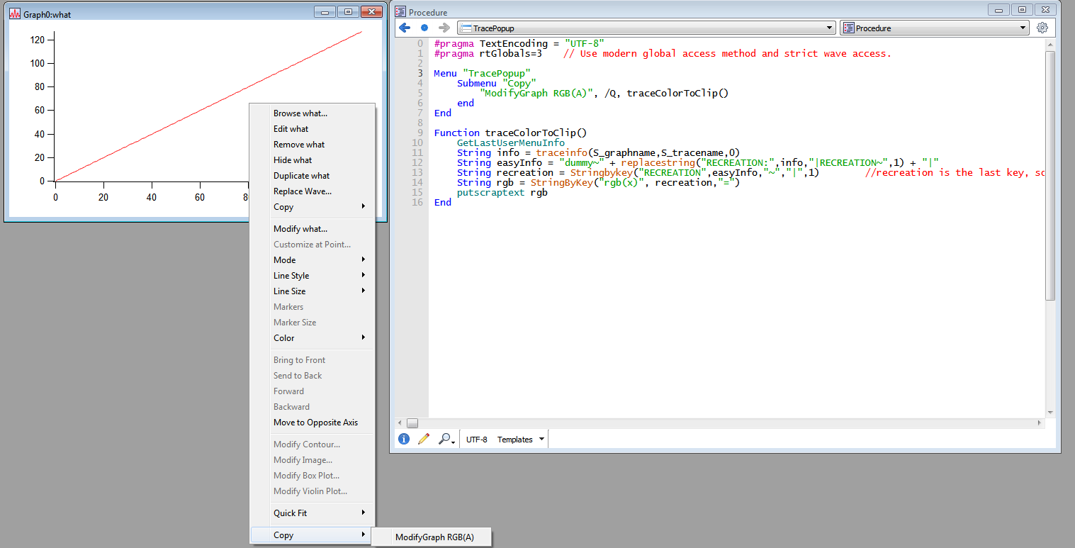

To make my question a little more concrete, here's a picture of the trace popup menu the code above produces. There are two "Copy" submenus. I'd like to combine them into one (retaining all the built-in submenu items).
Duplicate submenus screenshot (78.95 KB)
Appending user menu items to the TracePopup's Copy submenu is not possible in the current version(s) of Igor, sorry.
