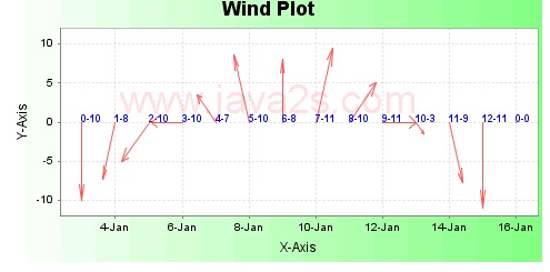

facehappywy
Thanks. I think I may not be very clear on what I need. The script you list is too complicated in my application. I only want to make a simple vector plot as shown in the attachment.

hrodstein
Here is a simplified version that just creates lines with arrowheads:
// Make XY data
Make/O xData = {1, 2, 3}, yData = {1, 2, 3}
Display yData vs xData                // Make graph
ModifyGraph mode(yData) = 3        // Marker mode
// Make a barb data wave to control the length, angle and number of barbs for each point.
// To control the number of barbs, column 2 must have a column label of WindBarb
Make/O/N=(3,2) arrowData    // Controls line length and angle
Edit /W=(439,47,820,240) arrowData
// Put some data in arrowData
arrowData[0][0]= {20,25,30}    // Column 0: Line lengths in points
arrowData[0][1]= {0.523599,0.785398,1.0472}        // Column 1: Line angle in radians
// Set trace to arrow mode
ModifyGraph arrowMarker(yData) = {arrowData, 1, 4, 2, 1}
For details read about the arrowMarker keyword of the ModifyGraph operation.
Also choose File->Example Experiments->Feature Demos2->Barbs and Arrows.
And File->Example Experiments->Graphing Techniques->Arrow Plot.
