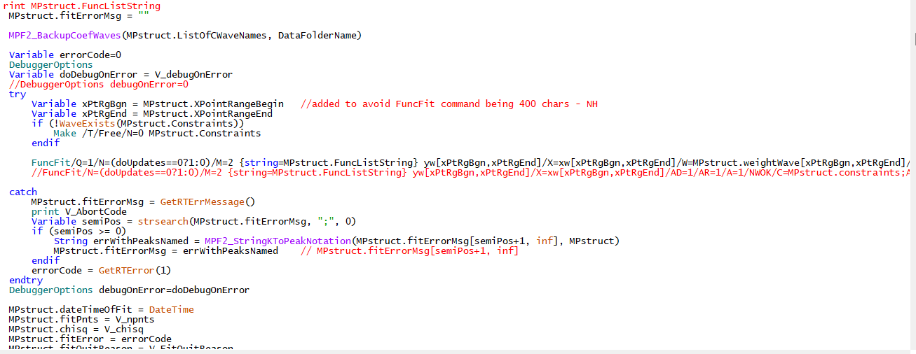

I continued to do more programming of my own using the multipeak fitting for igor programmers help topic. I was able to automate the process through the auto-locating peaks. However, I ran into an error that stated "expected name of target window" associated with the funcfit code line after I call the do multipeak fit procedure. I can see the graph updating and it appears to work, but at the end of the code does not apply the final fits to the graph. I have attached a snippet of the code below that uses the funcfit line.
What should I try to get rid of this error?
Screenshot 2023-06-30 091345.png (62.4 KB)
Your screen capture doesn't include the end of the FuncFit command, where the /D (autodestination wave) specification will most likely be, but I assume it's there. The /D flag modifies the topmost graph *if* the Y data wave graphed there.

FuncFit/Q=1/N=(doUpdates==0?1:0)/M=2 {string=MPstruct.FuncListString} yw[xPtRgBgn,xPtRgEnd]/X=xw[xPtRgBgn,xPtRgEnd]/W=MPstruct.weightWave[xPtRgBgn,xPtRgEnd]/I=1/M=MPstruct.maskWave[xPtRgBgn,xPtRgEnd]/AD=(doAutoDest)/AR=(doAutoResid)/A=1/NWOK/C=MPstruct.constraints;AbortOnRTE
//FuncFit/N=(doUpdates==0?1:0)/M=2 {string=MPstruct.FuncListString} yw[xPtRgBgn,xPtRgEnd]/X=xw[xPtRgBgn,xPtRgEnd]/AD=1/AR=1/A=1/NWOK/C=MPstruct.constraints;AbortOnRTE

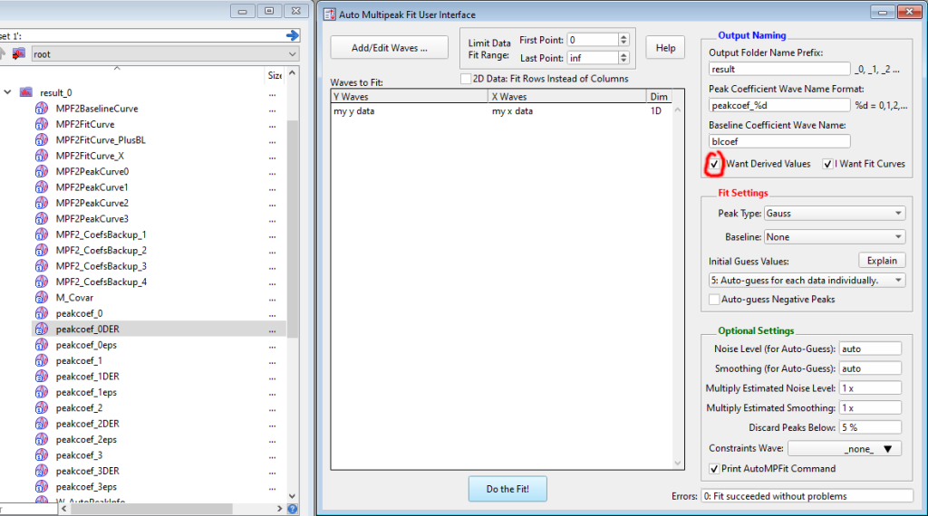

Yes, automatic batch fitting does not show you a ready made table or notebook. The idea is that you use this in your own code, so you need to grab and present the results yourself as well. You would 'just' need to invest some time to write code for generating a nice notebook in the way you want from the results of automatic batch fitting. May I ask for what purpose you want a table / notebook? Printing, as a log, or ...? The benefit is that automatic batch fitting is much more flexible to adapt to your needs. For example, it is easy to define the background type, which would be a difficult task to do via code the way you are currently trying to do things with the UI.
Here is a screenshot where I set up the Automatic Multipeak Batch Fitting UI to fit data from the Multipeak Fit demo, which took me only seconds. Note that I have checked the checkbox 'I Want Derived Values', which create these '...DER' waves in the output folder. These hold then the standard parameters like location, fwhm, area etc., just like you are used to see in the MPF table / notebook. It would then only be a relatively small task to create an output / summary of your liking from these.
