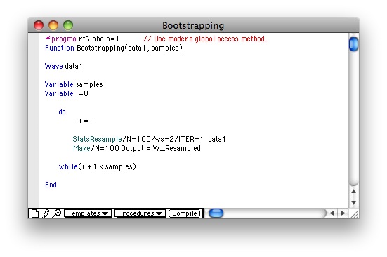

Thank you A.G. The problem was indeed that W_Resampled was not visible. Following your recommendation I have tried to create a Bootstrapping function (see attachment). However, I am still uncertain about how to define my output wave. Is it possible to define my output in such a way that the output wave can be updated for each iteration; for example by using the value of i, so that for 50 iterations (samples), the W_Resampled is being transferred to the waves wave1 up to and including wave50? I have the idea that strings might bring the solution, but don't see how. Any suggestions are welcome.

Hello Eduard,
I think you would be better off using something similar to the following code:
// The following function creates 2 2D output waves.  One contains a column
// for every "resampling" and the other contains a column for the corresponding wavestats
// results.  Note that M_WaveStats has dimension labels that define the quantities stored
// in each row.  Use Edit M_WaveStats.ld to display in a table with dimension labels.
Function makeSamples(inWave,numWaves,numSamplesPerWave)
	Wave inWave
	Variable numWaves,numSamplesPerWave
	Variable i
	Make/O/N=(numSamplesPerWave,numWaves) M_Resampled
        // now create a wave with correct dimension labels for wavestats:
	WaveStats/W/Q inWave
	Wave M_WaveStats
	Duplicate/O M_WaveStats,M_ResampledStats
	Redimension/N=(-1,numWaves) M_ResampledStats
	for(i=0;i<numWaves;i+=1)
		StatsResample /N=(numSamplesPerWave) inWave   // only performing the resampling.
		Wave W_Resampled
		M_Resampled[][i]=W_Resampled[p]    // store the resampled data
		WaveStats/Q/M=2/W W_Resampled    // compute wavestats
		M_ResampledStats[][i]=M_WaveStats[p]  // store the stats.
I hope this helps,
