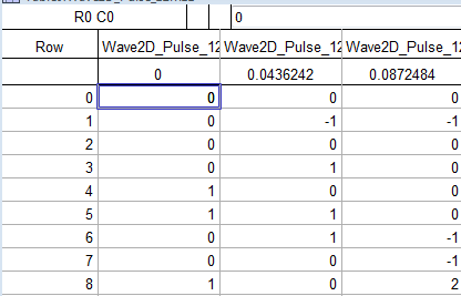

I have built a 2D histogram, and I would like to create a function that essentially does the following:
From row 1 to 2, sum the values for every individual column. Histogram the summed values into a 1D histogram.
I understand the following snippet sums all columns in the matrix, but I'm not sure how to add the condition of a row range.
MatrixOP 1DHist=sumCols(2DWave)
I have attached a picture of the 2D histogram matrix. For example, for rows 1 to 2, column 1 sums to 0, column 2 sums to -1, and column 3 sums to -1. I want to store these values in a single wave and histogram them into a 1D Histogram
Thanks in advance.
