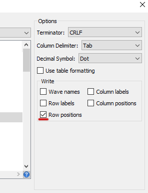

By the way, you can also save the fit result, or any waveform model data for that matter, as X/Y-data in a tab-delimited text file without doing the extra step of writing out the x wave (as explained by John). Just check the 'Row positions' checkbox in the Delimited Text export dialogue and the x scale will be written as the first column in the file (see attached screenshot).
