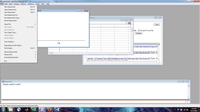

I'm encountering a problem where I have to fit one set of data (image attached) with two different fittings: first part with linear fitting, the other part with polynomial. The problem here is that I have to FIND the BEST transition point where I can switch from the linear fitting to the polynomial fitting.
I wonder if Igor has a sort of built-in functions that deal with that kind of problems. Any Igor-suggestions or general suggestions regarding solutions to the problems will be appreciated. Thanks!
