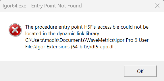

However, when I run Igor and call the XOP, I get the following error:
This is strange because the XOP was working with other dlls I incorporated into the project using the same methods. I have all dll dependencies in the same directory as the XOP (Igor Extensions (64-bit)) (including hdf5.dll and hdf5_cpp.dll). I also have the H5_BUILT_AS_DYNAMIC_LIB preprocessor definition set. This has worked for all my other projects so far, yet there is nothing I have found will work with Igor and the HDF5 library. The one thing I did find strange was the H5Fis_accessible entry point exists in hdf5.dll (not hdf5_cpp.dll as the Igor error message states) examining the dlls with the Visual Studio dumpbin command. I have ruled everything else out, as the XOP operation completes successfully when I comment out the single reference to the HDF5 library.

Starting with Igor Pro 9, Igor's HDF5 support is built in and the Igor HDF5 library files ship in the folder containing the Igor64.exe application file.
I think your XOP is dynamically linking with Igor's hdf5.dll library. This is version 1.10.7 which does not have the H5Fis_accessible function which, I believe, was added in 1.12.
The XOP manual says:
I think this is not working because the hdf5.dll library is already loaded so Windows does not search for it.
One solution is to use the hdf5 libraries included with Igor. The documentation for version 1.10 is here.
The only other option is for you to link statically with the hdf5 libraries. The HDF5 download web page says "Static libraries begin with lib and shared libraries do not. For example, hdf5.lib is the shared library and libhdf5.lib is the static library" so apparently static libraries are included with the precompiled libraries.

This resolved my issue, I greatly appreciate the help! It's good to know that Igor uses version 1.10. I was thinking along those lines, but I had completely missed the hdf5 static libraries.
