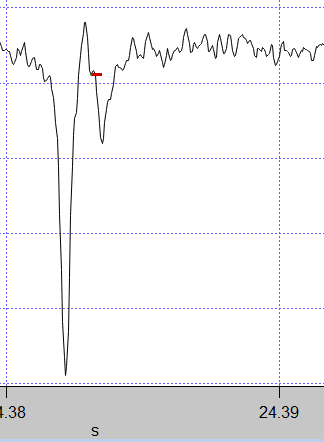

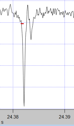

I’m an avid user of Igor Pro and also, especially, the Neuromatic extension! I recently got into event analysis (slope detection mode), which works very well. However, I’m having some troubles with the uniqueness (criterion). I’m using the event detection for spike detection (single-cell loose-patch recordings in voltage-clamp mode). Sometimes the currents have a very specific shape (double-negative deflection), that can also have a quite similar amplitude. Usually, Igor would detect the first negative peak as an event (what I want) but then quickly move to the next peak (that belongs to the same spike) and ask to replace the first one (what I don't want). I already tried to play around with "skip points until next event" and the uniqueness window, but it doesn't really work and I have to manually curate every single detected spike, which is quite time-consuming or choose a lower threshold, which makes me loose some smaller spikes...Does anyone have an idea how to fix that? Since I know my minimal interspike intervals, I would ideally like to give an option to really skip e.g. 10 ms until the next spike should be detected (which is not working via the "skip points" option).
