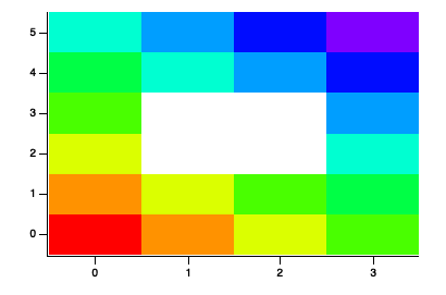

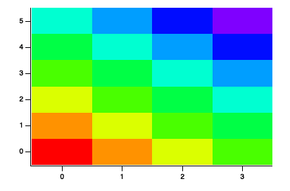

I have a 2-D matrix which contains NaNs, and would like to interpolate to fill those NaNs. For now, my simple approach was to extract each column into a 1-D wave, do a linear interpolation and replace that column in the matrix. What are some better approaches to this? I could not find a suitable command to do this more directly.
Thanks

A simple approach is to convert the data that you have (surrounding the nans) into a triplet wave and then use ImageInterpolate Voronoi. Let me know if you need more details.

One approach might be to treat the matrix as an image wave. Use the RemoveBackground operation with a first order plane. Substitute the resulting values in the background matrix for the NaN values in this matrix.

Isn't this what MatrixFilter NanZapMedian was designed to do?
MatrixFilter [/b=b /M=rank /N=n /P=p /R=roiWave /T] Method dataMatrix
The MatrixFilter operation performs one of several standard image filter type operations on the destination dataMatrix.
NanZapMedian n xn filter that only affects data points that are NaN. replaces them with the median of the n xn surrounding points. Unless /P is used, automatically cycles through matrix until all NaNs are gone or until cols *rows iterations.
February 1, 2021 at 06:43 pm - Permalink
MatrixFilter with zapMedian works better when you have isolated NaNs. In this case the NaNs seem contiguous so Voronoi interpolation is likely a better approach.
