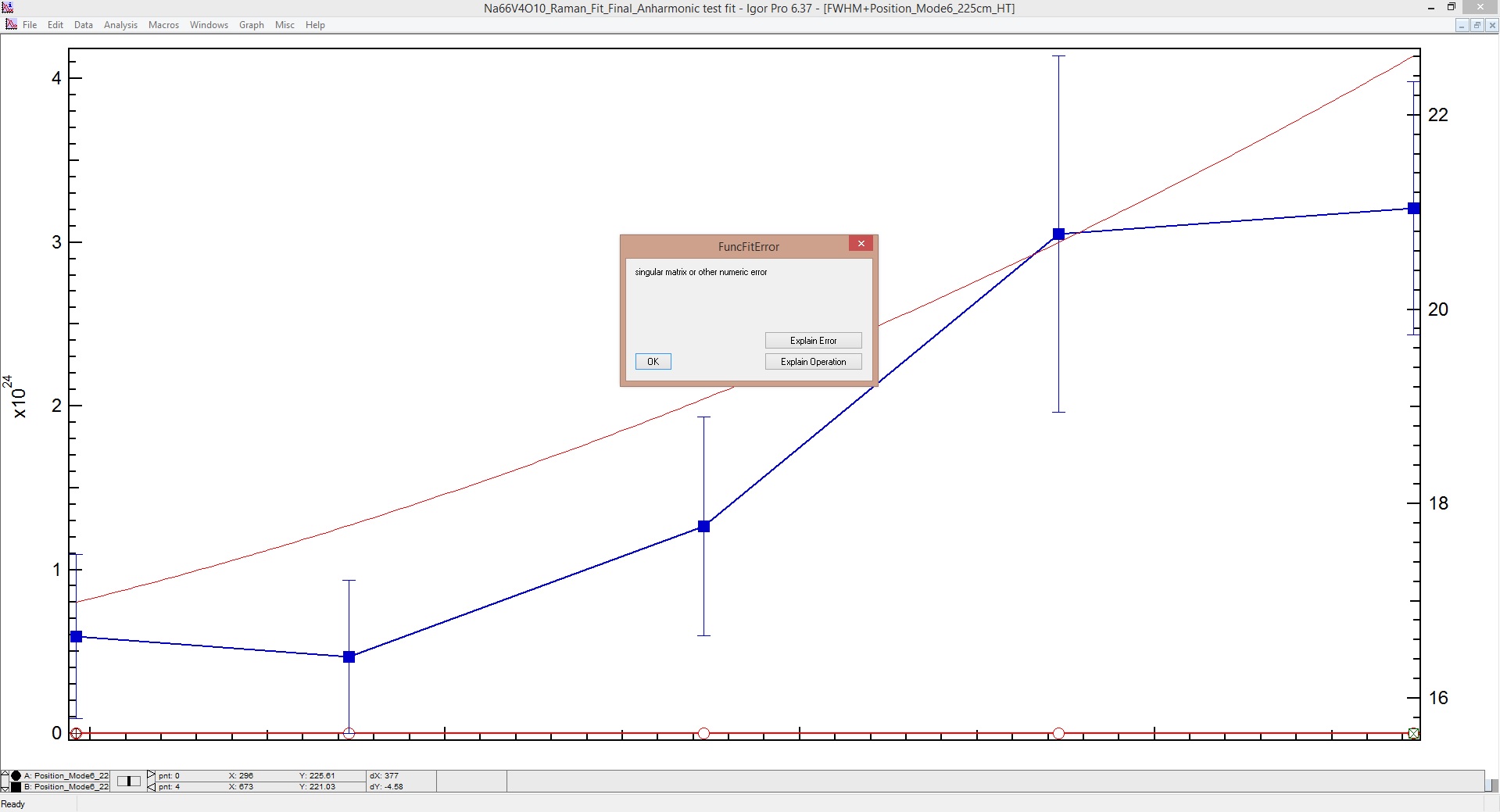

matrix error in wave fitting?
 singular matrix or other numeric error.
I don't understand the error and it should not show this when fitting a curve or am I missing something?

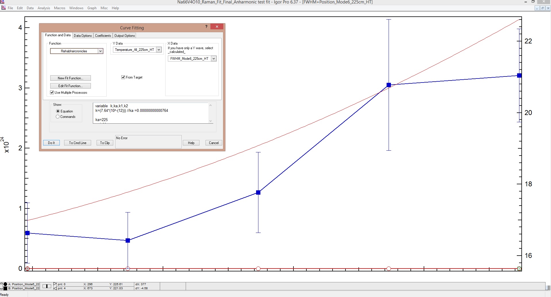

curvefitting dialog wave selected error shown by curve fitting dialog trace information dialog Equation that I wrote in the procedure
