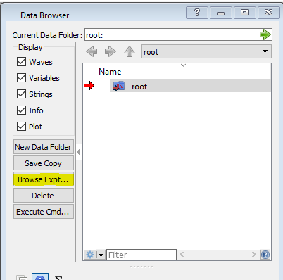

Hello everyone,
I am using IP 7.08 and I would like to know if there is a way to migrate a DataFolder from Exp1 to Exp2. I tried by dragging and releasing the DataFolder with both experiment instances opened but this does not work. My problem is that I do not want only to recreate a Graph (of Exp1) as an experiment that can be migrated to Exp2. There are waves inside the DataFolder that have been partially treated and I need to reuse them on Exp2. Best,

See DisplayHelpTopic "Merging Experiments".

On the Data Browser there is a button, "Browse Experiment", which lets you look into and copy the contents of another Igor experiment file to the current experiment.

No need to be sorry for asking questions. You might want to prefer jtigor's solution as that is safer for starting igorians.
