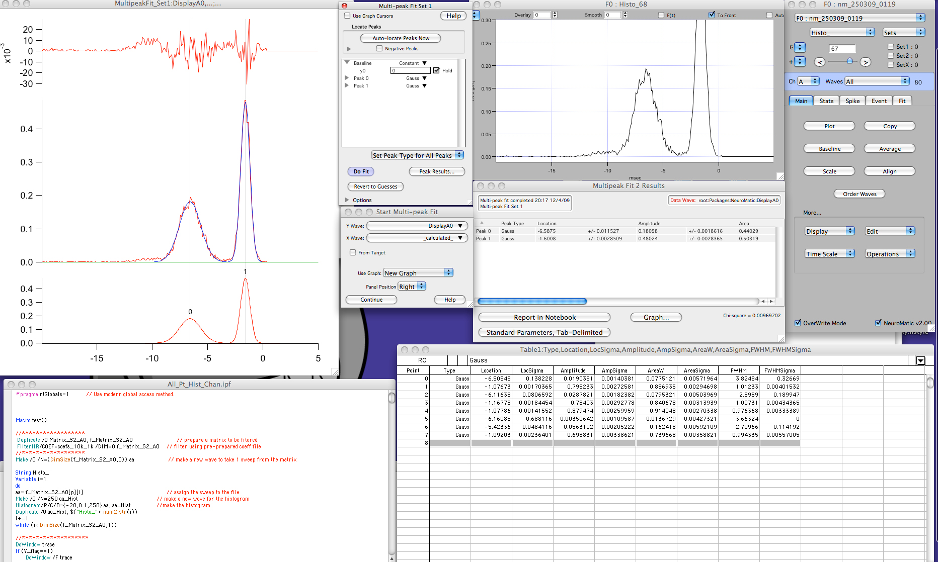

As to getting Multi-peak Fit 2 to overwrite, I am fitting histograms generated with the Histogram function then loaded into NeuroMatic and displayed in a window where the trace is always named 'RecordA0' - I set the Multi-peak fit to use RecordA0 the contents of which changes each time I tab forward through the histrograms in NeuroMatic. Does this make sense? See attached screen grab.

mf wrote: Thanks for the feedabck, I was trying to avoid the copy-and-paste route...
I see. I don't know Neuromatic very well, but it sounds like the graph in Neuromatic is overwriting a wave with new data for each data set. So Multi-peak Fit 2 thinks it's always the same wave and same graph, so it interprets it as the same fit set.
I will put appending to a results notebook on the to-do list for Multi-peak Fit 2.
