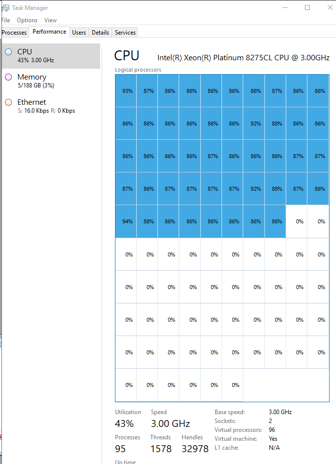

Thank you for the response. I was not being very clear; i will try to add more details:
All virtual servers we are testing have DUAL SOCKET virtual processors - two cpu 'nodes'. for some reason, Igor can only utilize one virtual processor, not both. On similar physical computers , this is not an issue - Igor can use all the cpu cores and 'threads' even if it's on a dual processor system.
I do not have low level access to the AWS virtual environment; i only have the info that the OS is telling me.
I starting this test again on a different Windows 2019 server with TWO of these processors totalling 96 available threads (AWS c5.24xlarge):

The code is using ThreadProcessorCount and ThreadGroupCreate()
I will keep testing more types of virtual CPUs but it would be nice to get more then 48 threads going at the same time when the OS seems to think there are 96 available threads (even if it's maxed out at 64 - that's ok).

What you report in your last comment is described at https://chrisgreendevelopmentblog.wordpress.com/2017/08/29/thread-pools-and-windows-processor-groups/. Search for "Long story short:"
Any process has access to all the threads in a single processor group. Since your machine has > 64 threads, it has 2 processor groups, each with 48 threads. So any single instance of Igor has access to 48 threads. If you were running two Igor process at the same time, and if the OS assigned each process to a different processor group (I don't know how you could test for this fact), then you could theoretically use 96 threads at a time.
As far as I know there are no machines available with >64 threads that are not outrageously expensive. OK, the Ryzen Threadripper 3990X is 64-core/128-thread and about $4000 (just for the CPU), which isn't quite outrageously expensive, but it's pretty close. With covid-19, it's going to be pretty difficult to get parts to build a machine with that processor.
That's a long way of saying that your use case is currently very extreme and probably not something we can add support for, at least in the near term.
If you want to provide more information about exactly what you're doing, and where you think the bottlenecks might be, we may be able to help you write more performant code even if it can't take advantage of *all* of your cores. Feel free to contact us directly via email instead of on the forum. Even if you've written your Igor code as efficiently as possible, we can run it under a profiler and see if we might be able to improve Igor's performance.
April 2, 2020 at 11:35 am - Permalink
