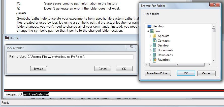

Is there a way to get a dialog similar to the open file dialog, just that the user can select a folder instead of a file?
I am asking the user for a location to save multiple files of auto-generated names. It would be quite unhandy if the user had to type in some file name in the save file dialog when i just need a folder...
Thanks for your help!

But I'd like to have a dialog where the user can browse to the folder he wants to use. Simple asking for a path is no problem even without the newpath operation.
Is there really no other choice?

path: "C:Users:Jim:Documents:"
See the attached screen capture.
January 4, 2011 at 11:10 pm - Permalink
Big excuse, I did not read the NewPath documentation properly!
Thank you!
