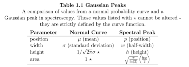

The Gaussian peak in XPS/UPS is defined as ...
I(E) = h\ \exp\left(-4\ \frac{\ln(2)(E - p)^2}{w^2} \right)
... where I(E) is intensity, E is energy (BE or KE), h is peak height, p is peak position, and w is the width at half-maximum height.
The parameters of the two are defined as shown in this table.
(the LaTeX equations can be parsed from ... http://www.codecogs.com/latex/eqneditor.php)
