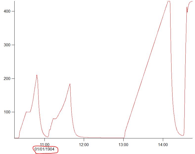

Thank you! I have tried both. As you said, second option shows too much ticks. For the first option, I plot the image shown below. How to remove the marked default year and date?

Go to the Ticks and Grids tab inside the Modify Axis dialog and set Suppress Date for Date/Time Tick Labels.
April 27, 2023 at 05:46 pm - Permalink
You might even want to set the horizontal axis Time Format to Elapsed.
