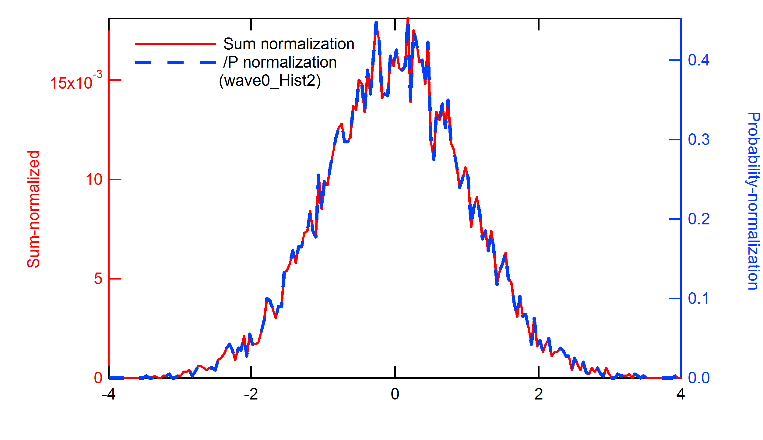

(1) Doing the division as you indicated caused some strange effects for me (IP 6.22A, Win Vista). Finding the sum first, and then dividing worked OK, but does not give the correct p.d.f. for reasons I stated above involving the x-axis scaling and bin density.
(2) I did the /P histogram and plotted it on the same graph (but right-hand axis, blue). Its area is close to one:
0.9999
The left-hand axis plot (red) using the sum division is not properly normalized for a p.d.f.
February 22, 2012 at 07:28 am - Permalink

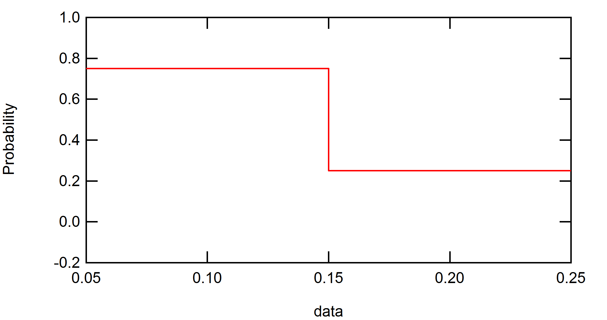

make/O/N=4 wtest = {0.1, 0.1, 0.1, 0.2}
make/O/N=2 whist
histogram/B = {0.05, 0.1, 2} wtest, whist
whist /= numpnts(wtest) // each point is a probability of that bin
The customer is always right, but the request to "normalize the histogram to probability " had an ambiguous meaning. I think this horse is dead now.
