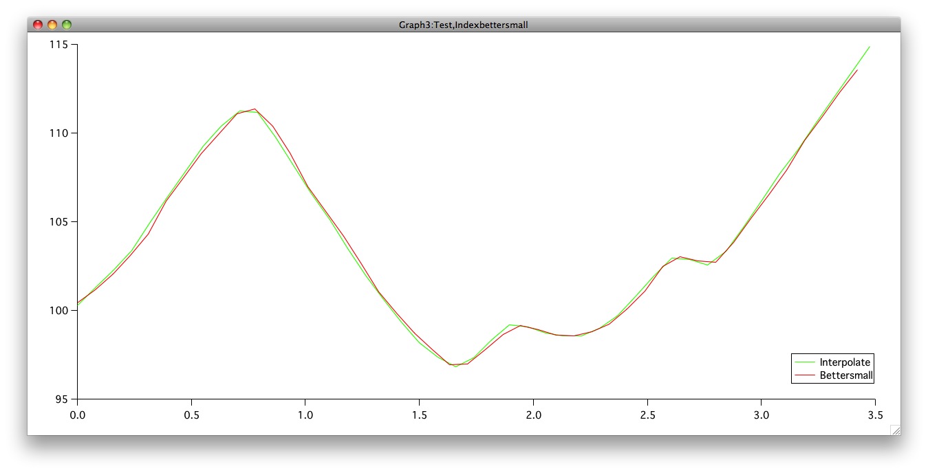

Thanks to both of you. With your advice I got what I was looking for. I discovered that the shape of the larger data set was maintained with the decimation method and also with the interpolation function, if I set the smoothing factor at zero. See the attached graph.
