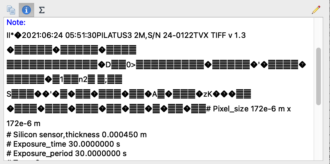

I am loading a header of a tiff image. The header was successfully loaded as a string but it contains some non-readable characters.
Is it possible to remove these non-readable characters from the string?

First, you might consider using Igor's ImageLoad operation to load your tiff file. It creates an S_info output variable. While that isn't currently documented (I have asked the author to document it), it contains the "# Pixel_size..." string that I think you are trying to get. ImageLoad contains flags that allow you to read the tags from the image. You can also read just the metadata without reading in the actual image (/RTIO flag).
If you want to eliminate the non-printable characters (most of which are due to null bytes in the string), you could use this ConvertTextEncoding command:
String converted = ConvertTextEncoding(header, 1, 1, 3, 2)
That will treat the input string as UTF-8 (ASCII is valid UTF-8) and convert to UTF-8. Any invalid UTF-8 sequences will be silently dropped.
July 20, 2021 at 07:47 am - Permalink
Thank you very much for the help. ImageLoad/RTIO works perfectly.
I have also tried the CleanupName and ConvertTextEncoding, but these codes could not remove the non-readable characters.
