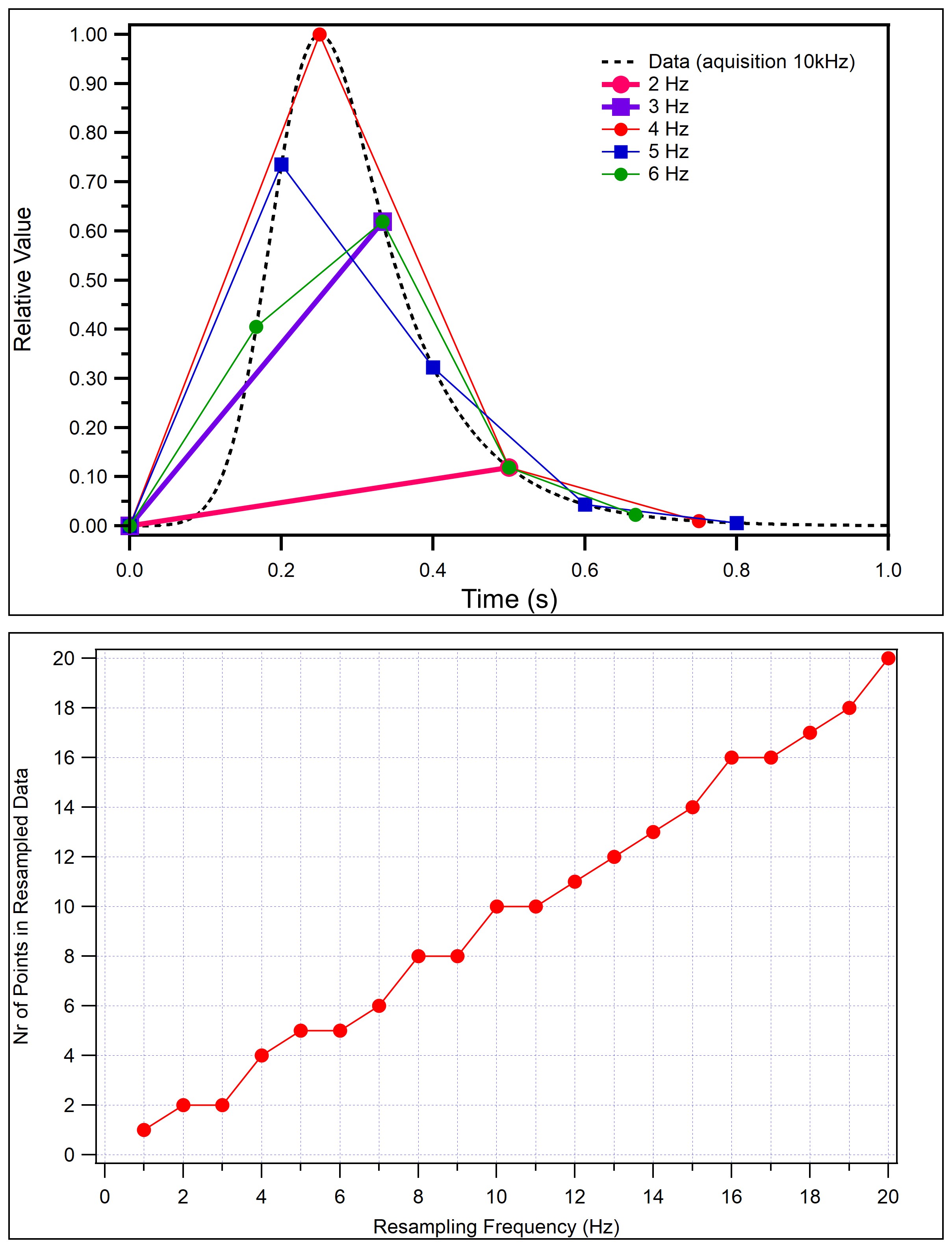

In attachment I try to illustrate the behavior of show the result of the resampling the data shown by a dotted line. When data is subsampled to 2Hz over 1 second it produces 2 datapoints as expected, but when is resampled at 3Hz it still continues to produce only 2 datapoints, albeit at different timepoints.
The lower graph in attachment tries to illustrate how this difference between resampling frequency vs number of datapoints found in the generated resampled waves expands higher resampling frequencies.

I can later attach the experiment, for now, simply my question is that if I sample my data at 3Hz for a dataset that spans over 1 second, I would expect to have datapoints for timepoints 0, 0.3333 and 0.66666 seconds. In my example however, for /Rate=3 I have only data for time points 0 and 0.333333 (so only 2 datapoints, not 3)

So, in this example since the time period of the pulse is one second, I would expect the number of data points generated by the resample operation flagged with /rate=3 to be 3 data points, instead I get only two. Likewise, for /rate=6 I get only 5 points and this occurs throughout the entire frequency range.
