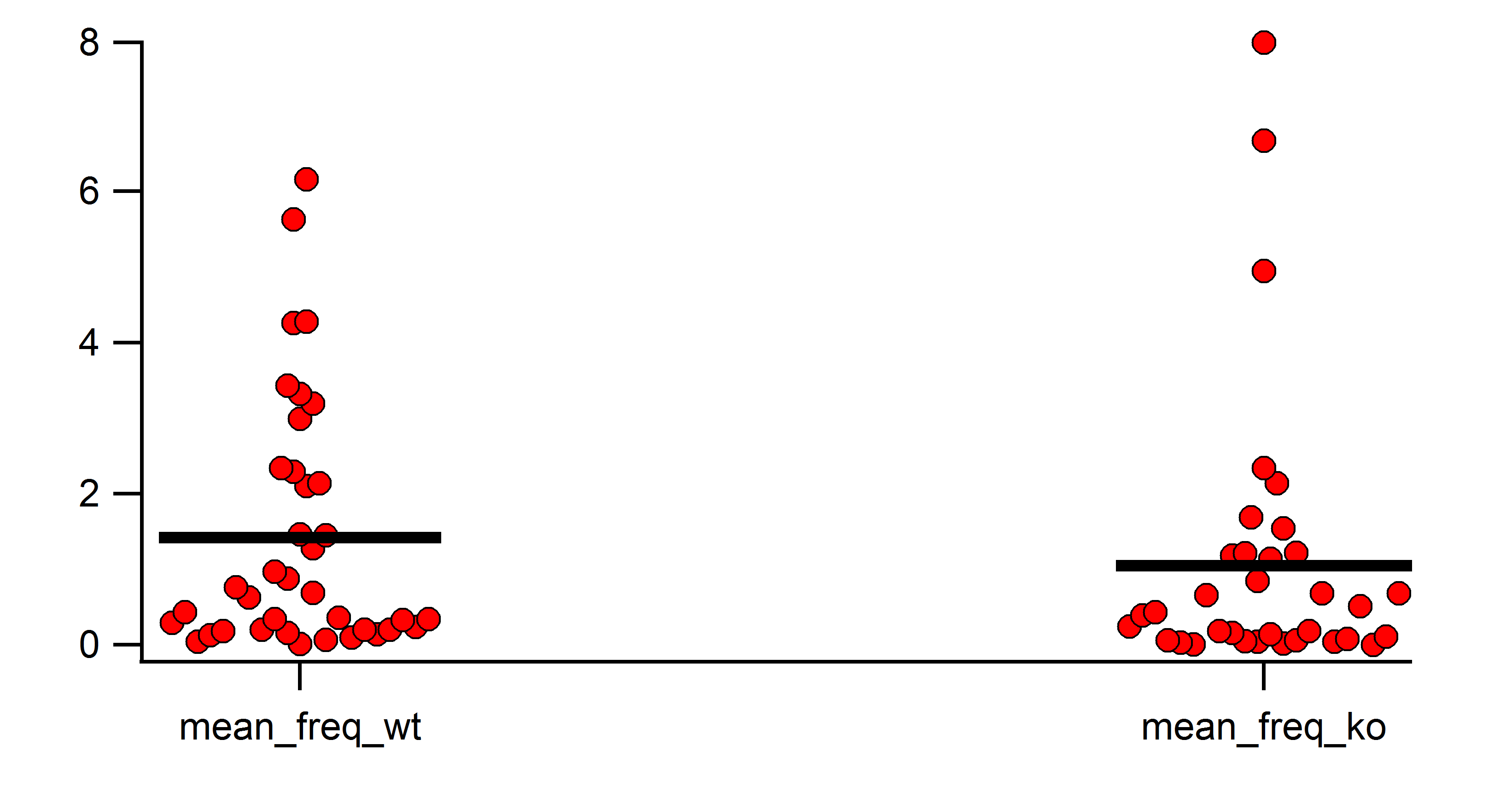

This is the graph I am speaking about

That is a category plot and it should also be done the same way. Can you share a bit of data in an experiment file?

The Scatter Dot Plot package still ships with Igor 8, and it should still work just like it did in Igor 6. What do you see in the menu
Windows->New->Packages? Scatter Dot Plot should be there.
In Igor 8 you can also use a box plot and simply set the box and whisker lines to zero thickness. You can also use a violin plot the same way.
