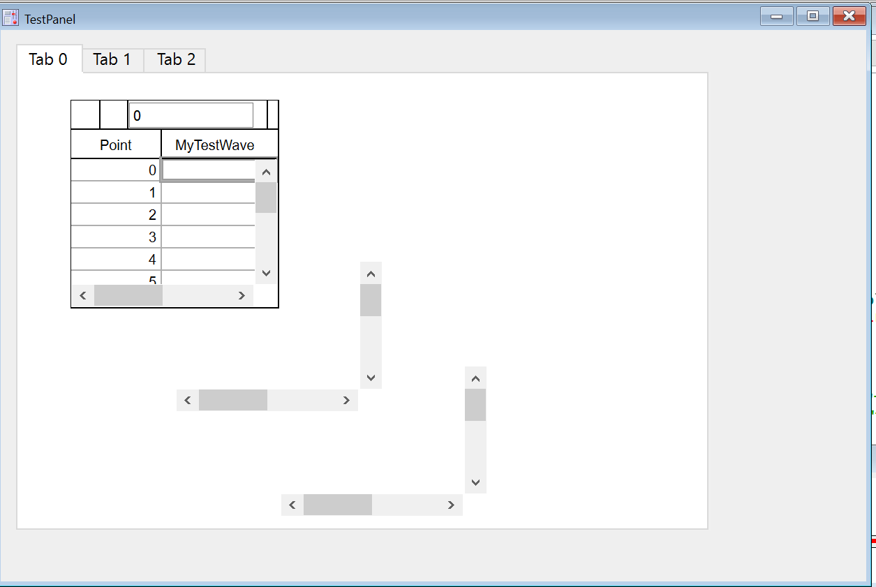

I just upgraded to Igor 9.01 from Igor 8, running on Windows 10 Pro (64-bit). I have a function that builds a panel with various tabs and tables. When I upgraded, I noticed odd behavior when the panel first builds. Here's an example of a function that makes a panel with three tabs, with a table on each. Toggling between each tab shows that tab's table, and hides the other two. In Igor 8, this worked fine.

But now, when I run MyTestPanel(), the scroll bars for the two hidden tables show up (see picture below). Toggling between the all the tabs with MyTabControl() eventually hides the entire table, but I don't understand why the initial /HIDE=1 flag in MyTestPanel() seems to only hide the table, not the scroll bars.
Has anyone else had a problem with this in Igor 9.01?

This is a known bug, and it has been fixed. Please select Help->Igor Pro Nightly Builds and download the latest bug fixes.
