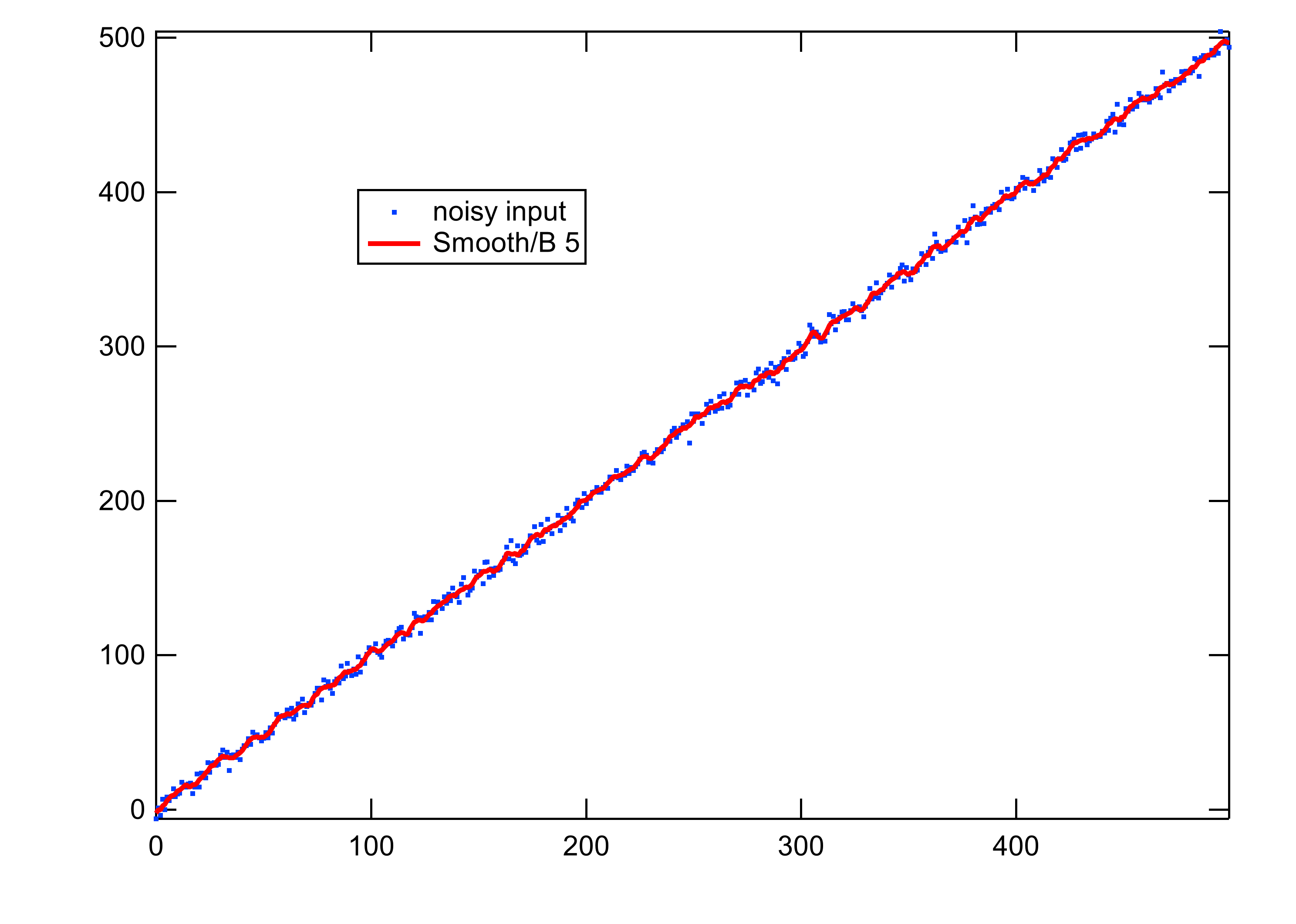

I fail to understand your argument. Attached is a simple example of linear data with Gaussian noise, and its Smooth result
A resulting graph is attached. Both waves have 500 points.

In reply to Joel, I fail to understand… by s.r.chinn
I think Joel is making the case that the result of 5 point averaging should be condensed (decimated) into a wave that is only 1/5th the length, with each point representing the average of the 5-point window.
The Decimate procedure does this:
#include <Decimation>Contains the Decimate procedure which creates an output wave by averaging every n points of the input wave down to a one point in the output wave.
