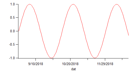

A simple test shows the x axis using date format properly:
make/O wy=sin(x/8)
make/O wx= datetime+p*3600*24
display wy vs wx
After double-clicking the bottom axis and choosing "Date/Time" format, the bottom axis shows the dates because the dialog altered wx's data scaling to "dat":
•//Axis "bottom" mode changed to date/time mode. Units for wave "wx" changed to "dat".
