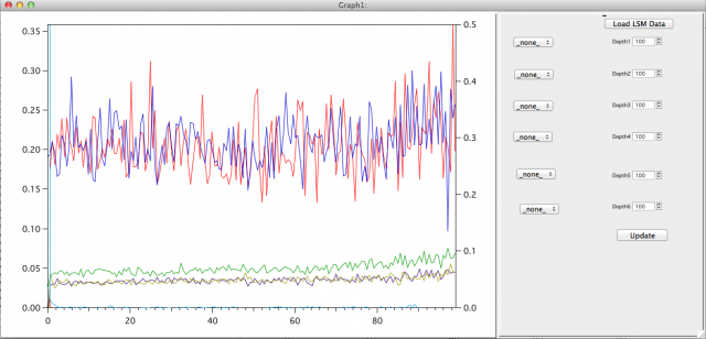

Does anyone have a procedure to update the Y wave in a graph using a popup menu (subwindow)? I have tried using ReplaceWave in the procedure of the popupMenu control, but that doesn't work more than one time, as the current wave would be different from the original wave when I try to change it a second time.
Any suggestion will be appreciated.

If this does not solve the problem then perhaps you can describe it in more detail or post a mockup so we can see what you are doing and what you are up against.
