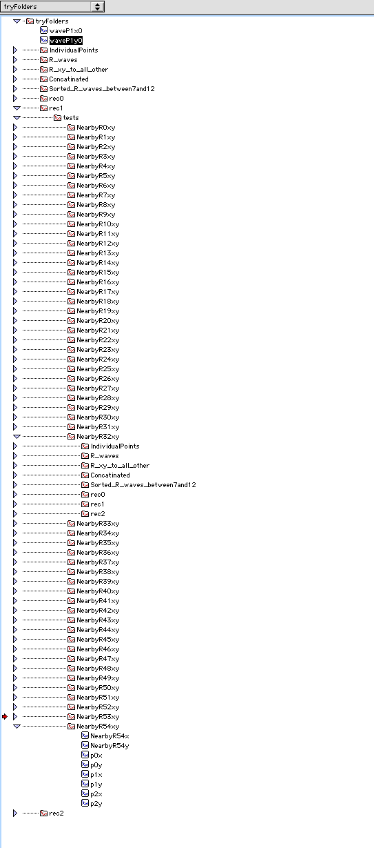

Hello Forum,
I have sorted my calculated waves and added them into 54 folders each called NearbyR_xy and are placed in folder named "tests" (as a result of previous For Loop). Each NearbyR_xy folder contains two waves NearbyR_x and NearbyR_y. My goal is to do some more calculation on each waves within NearbyR_xy folder. In this piece of snippet I use "while" and "for" loops.
When I execute my code, the operation is done only on last folder NearbyR54xy, the other folders contain no waves and have duplicates of parent empty folder.
The Error I'm getting is: " While ex
Also as you see in code rPxWave1, rPxWave2 and Rwaves1 supposed to give waves with names rr..xToAll, rr..yToAll and RR respectively. I don't know why those waves are not created.
I think it has to do with indexing and path,
Thanks for your help.

It is quite hard to follow, but two things spring to mind:
1. Try running your code with the debugger and step through each line to check that it is doing what you expect.
2. In your code snippet above you have the line:
DFREF tests = GetDataFolderDFR()
twice - once for this data folder: root:tryFolders:rec1:tests, and once for this data folder: root:tryFolders:rec1:tests:$(WaveNear). Is this really what you intended?
Good luck.
