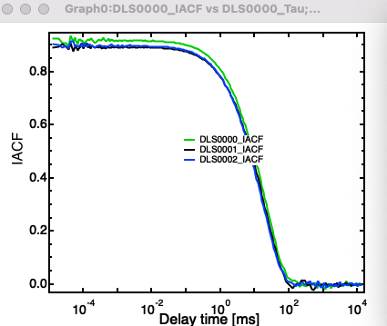

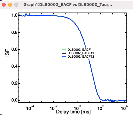

Hi, fairly new to IGOR programming. This has been bugging me for days. I am loading multiple similar files, plotting, then doing a simple calculation on each wave to create a new wave, all within a do loop. All the loaded waves behave sensibly. However the wave that I create to do the calculations on (wave w3 = $wnameEACF) keeps overwriting rather than generating a new wave for each file. I can't work out why this wave is different to the loaded waves.
Any help much appreciated. thanks Gary

Hello, thanks for uploading the code and files. It made this easier to troubleshoot.
The problem is that when you Duplicate wave1 to give wave3, a reference is made to wave3 so that although you rename the wave, you get the strange behaviour you are seeing. If you add
WaveClear wave3
Immediately after you rename all three waves, you get what is I think the desired graph.
I would do this a bit differently and use the desired name string for the Duplicate step and then declare that name as wave3, then do your calculation, and don't rename wave3 i.e.
Duplicate/O wave1 $wnameEACF
Wave wave3 = $wnameEACF
wave3/=mean(wave1,20,40) //Do calculation
//print wave3
rename wave0 $wnameTau
rename wave1 $wnameIACF
rename wave2 $wnameParam
AppendToGraph/W=Graph0 $wnameIACF vs $wnameTau
AppendToGraph/W=Graph1 $wnameEACF vs $wnameTau
or just name the waves directly upon loading to get rid of rename altogether.
