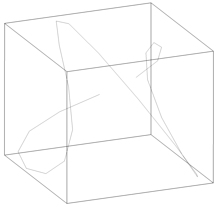

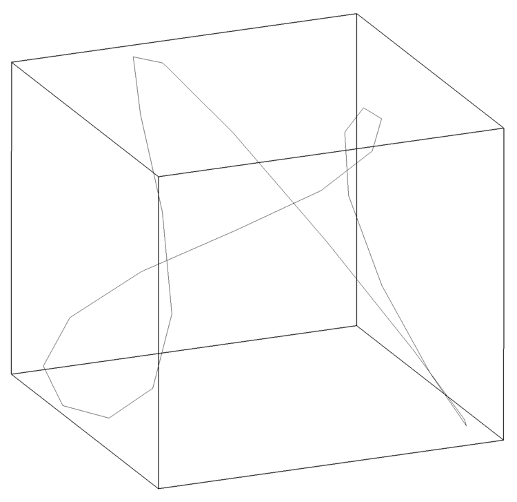

Starting with a new Gizmo window add a path object to the Object List. Click Do It in the Path Properties dialog and proceed to add a new (default) axes object. Drag the two objects and drop them on the Display List (order does not matter) and you will see something like this:

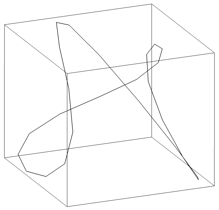

Recall that the original data is derived from a Lissajous figure so I'd like to see the two ends of the path connected to each other. To accomplish that I append a row to data3D and set it equal to the first row:
InsertPoints 25,1, data3D data3D[25][]=data3D[0][q]

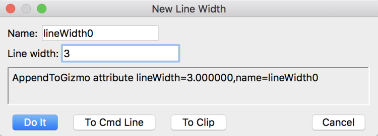

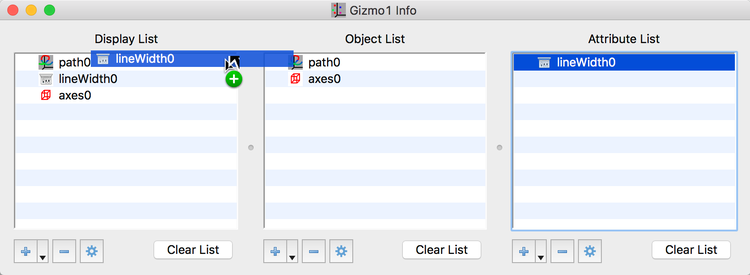

To improve the visibility of the path I'll add a line width attribute to the Attribute List.
and then drag the attribute to the display list dropping it above path0 object.
The new line width attribute draws the path using a heavier line.

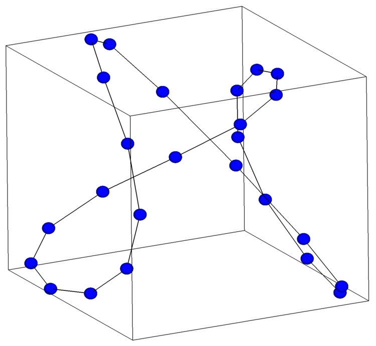

At this point I'd like to add a scatter object to highlight the location of the data points on the path. Following the same steps as in the previous post I add a scatter object that uses a custom blue sphere.

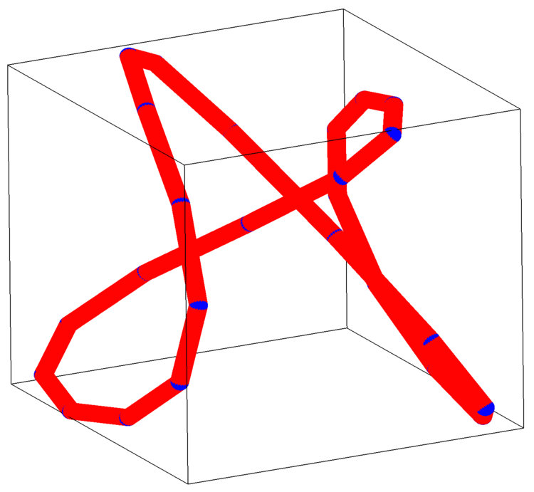

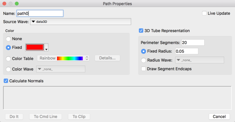

I can now take advantage of the spheres by replacing the path line with a 3D tube. The spheres are useful as they fill the tube's joints.
Note that the radius of the tube is equal to the radius of the spheres for a perfect fit.
Modifying the sphere color to match that of the tube and enhancing the plot gives us:
