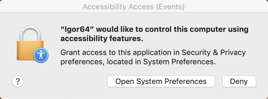

ACCESSIBILITY ACCESS (EVENTS) SECURITY DIALOG
Versions affected: Igor Pro 7 and Igor Pro 8
Description:
Initiating a drag in certain places, such as the Data Browser and the Gizmo Info window, can cause an Accessibility Access (Events) dialog, shown below, to appear:
In our testing, clicking Deny causes no problems. The Qt framework that Igor Pro uses creates a fake mouse event in the process of dragging, and this fake mouse event is triggering the security warning. According to the Qt bug report related to this issue, the fake mouse event is not actually necessary any more. Therefore denying accessibility access to Igor should not cause any problems.
Workaround:
- Igor Pro 7: No fix is available
- Igor Pro 8: Fixed in Igor Pro 8.03 (and later)
