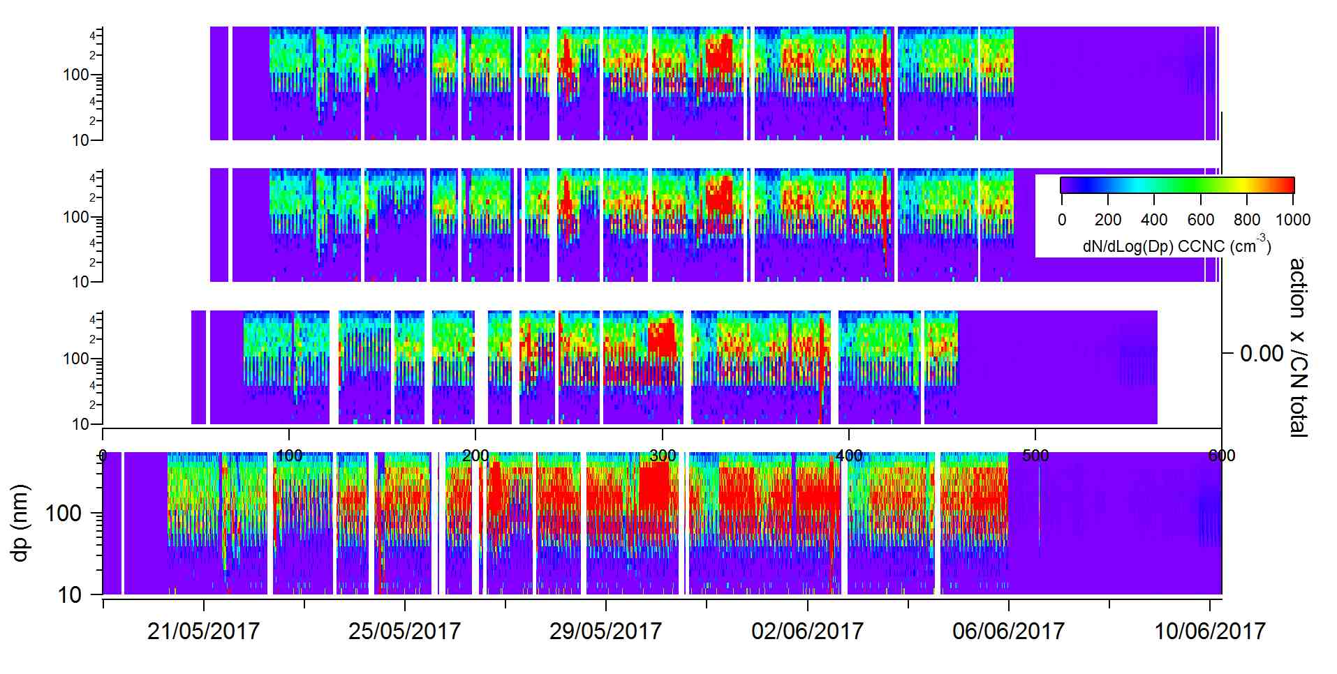

Just another Inquiry. My 2D images are very pixelated (see attached figure)! Is there a function to merge/smooth the colours better from one data point to another? (-to make a prettier figure). I think that this is possible to do with Matlab but not sure if it is possible to do with IGOR.
Thanks again
LaMP matrix plots.jpg (172.38 KB)
