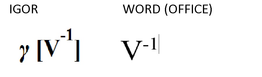

ChrLie You can tweak the position of characters using e.g. \x-20 or \y-20, where the number corresponds to an offset (in points??). In your case try: [V\S\y-25-1\M] See also: DisplayHelpTopic "Annotation Escape Codes" Log in or register to post comments August 5, 2019 at 03:23 am - Permalink
In your case try:
[V\S\y-25-1\M]See also:
