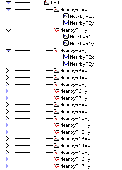

In attached image , folder "tests" contains number of folders "NearbyR_xy" each folder contains 2 waves. I want to do operation on each wave within folder ( e.g. "NearbyR0xy" )  and want to repeat it for the rest of the folders. What is the easiest way doing this?

here is how folders and files look like
