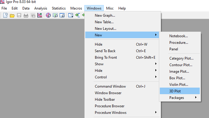

I'm trying to do 3D plots following the tutorial video.
However, when I try to go to the submenu of the 3D plots, I cannot choose any of the options (surface, scatter...) as there is no triangle next to 3D plots to open the list. What do I have to do or install to get it?
Thanks.
If you click on the "3D Plot" menu item, a new Gizmo and its Info panel should open. You can then add items to the three Info columns, e.g. add a Surface (with its type and source wave selection) to the Object List using the "+" button selector, and then drag the Surface object to the Display List.
If these windows do not open when "3D Plot" is selected, I suggest contacting WaveMetrics using the main Help Menu -> Contact Support...
