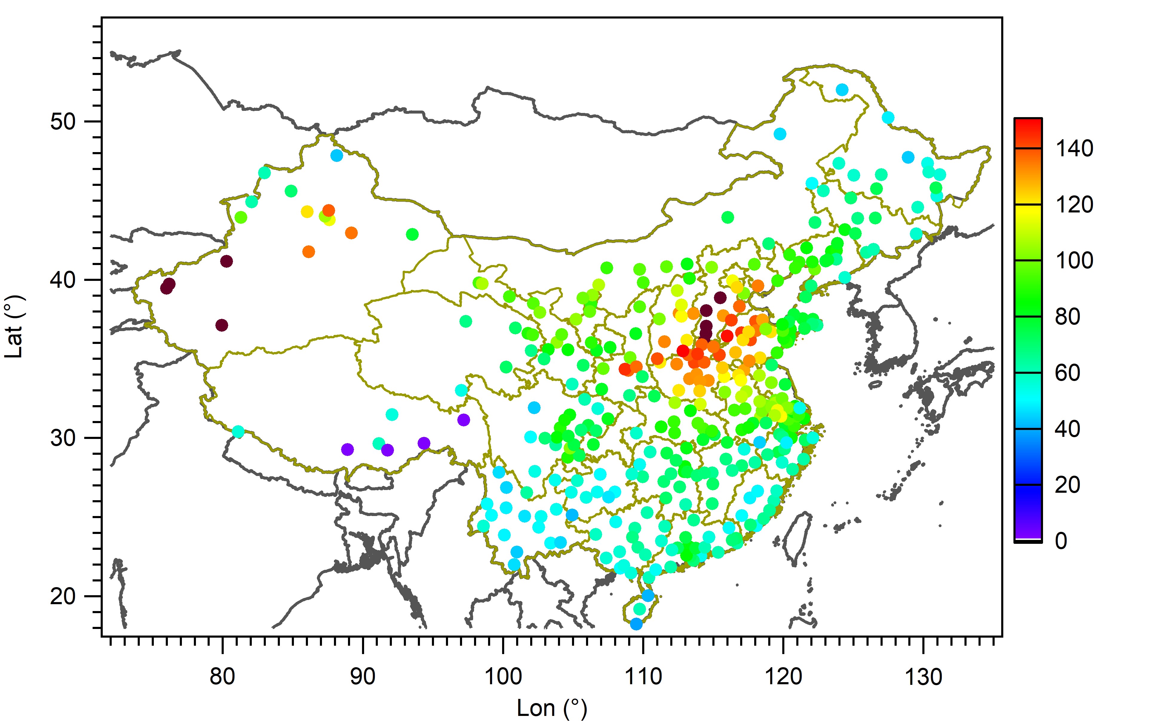

this is the Igor gis map as the longitude and latitude projection

Sorry for not clarifying my question in detail. Currently, I have some site data and world-map (including China) GIS data in degrees (like the above attacment). The question is how to show my site data in the world-map on the Lambert projection by using Igor?  Is there any Igor code or function for the users? I will be much more grateful if you can give me some suggestions!

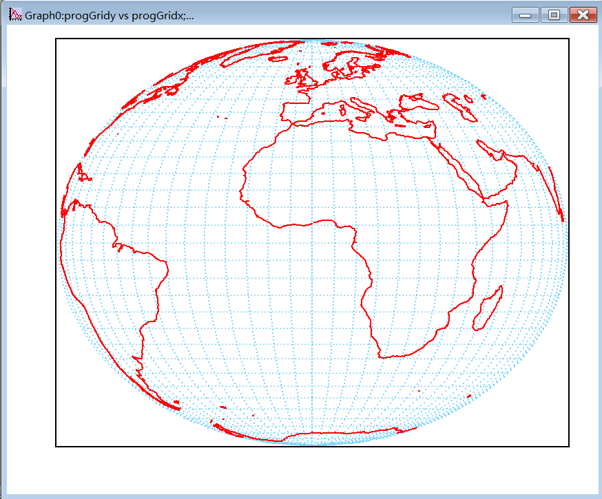

The project operation may require more than just input waves for the lambert projection.  Using defaults, you could execute:
project /m=4 lon,lat
display w_yProjection vs w_xProjection
If you want to enter specific parameters use:
project /c={centerLong,centerLat}/P={minLong,maxLong,minLat,maxLat}/m=4  lon,lat
I hope this helps.
AG
