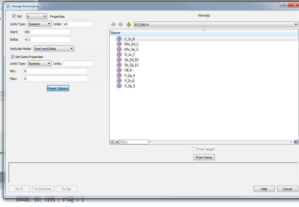

enclosed you will find my screen, the idea is scaling by 0.3 eV all the values this is usefull for the calibration on XPS spectroscopy. However, i don't know what kind of loop to use.

Function SetDelta(Delta)variable Delta
variable Cnt
String WaveNames=WaveList("*",";","")For(Cnt=0;Cnt<ItemsInList(WaveNames);Cnt+=1)wave w=$StringFromList(Cnt,WaveNames,";")SetScale/PxDimOffset(w,0), Delta, WaveUnits(w,0), w // Maybe you want to replace 'WaveUnits(w,0)' by ' "eV" ' as wellNote w, "Delta set to "+num2str(Delta)EndForPrint"Delta of "+Num2Str(Cnt)+" waves set to "+num2str(Delta)End
Make sure you've set the current data folder correctly. The function should only process the waves in this data folder. It will set the delta value to all waves in the data folder. It will only alter the x dimension.
Copy this code in the procedure window (Window->Procedure Windows->Procedure Window -/- CTRL-M).
Run it from the command line (history window). E.g.,
•setdelta(0.3)
Delta of 5 waves set to 0.3
HJ
PS: The scaling should match the spacing of the data points from the acquisition device. For calibration, the offset of the spectra might be shifted in a similar way. The value will depend on the position a reference peak (Fermi-edge in VB?). All spectra should be measured with the same photon energy in that case.
