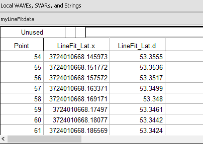

I still can't get it to work - here is my code and debugger details
searchTime = 3724010668.16396 (Variable)

Looks like your screenshot is a 1D fit wave, not a 2D wave. Then you simply use the wave scaling:
print LineFit_Lat(searchTime)
Note the curved parentheses.

Thanks Tony - that works - and so easy.
I obviously need to learn my dimensions :-)

The automatically generated output from curve fitting is waveform. Execute:
so x-values are computed rather than stored.
Igor interpolates linearly, but has no way of knowing how to extrapolate.
February 15, 2023 at 06:11 am - Permalink
