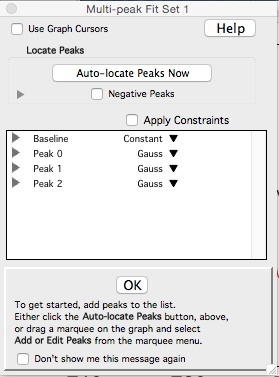

isendThank you! I was missing the "Do Fit" button because I never thought of clicking OK to make the tutorial message go away (to unblock the view)! (screenshot attached)
Sorry to have made an ignorant mistake.

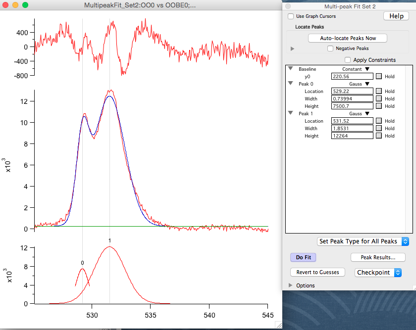

I was trying to fit a 2-peak curve (screenshot attached), but the range of Peak 0 it gave looked limited – its Gaussian shape did not extend and go to zero on either side/tail. What does this mean? Can I make it show the entire Gaussian curve for Peak 0? Thank you.
August 14, 2019 at 04:06 am - Permalink
The heuristic used to figure out the width needed to display the peaks sometimes fails. But you can have MPF2 make the widths as wide as your graph: Click the disclosure triangle labelled "Options" to display some additional settings. Turn on the checkbox labelled "Display Peaks Full X Width of Graph"
August 14, 2019 at 10:52 am - Permalink
