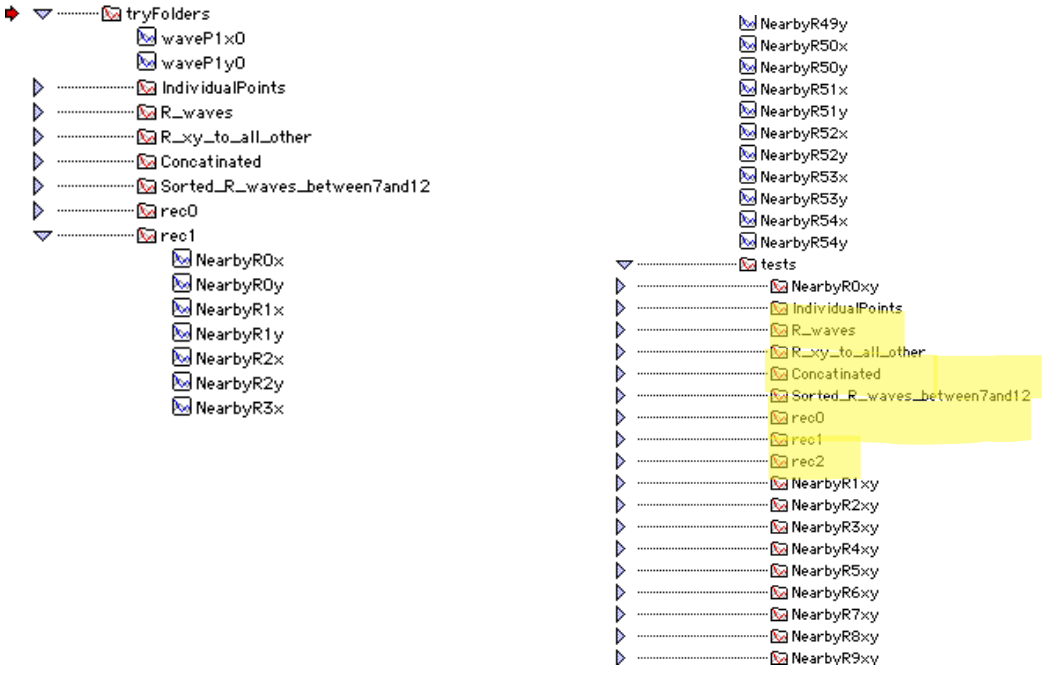

In my procedure, I am extracting data from waveP1x0 and waveP2x0 and doing some wave analysis. At one stage I need to move waves from folder "rec1" to "tests" such that for each pair (such as NearbyR0x and Nearby R0y) i want to create a folder that contains each point. When I run my code all the previous folders are also created in destination folder "tests" (the one that are highlighted in yellow), and the name strings "NearbyR"+num2str(b)+"x(or y)" are not moved the each corresponding folder.  I also get this error (while executing MoveWave, the following error occurred: expected wave name).

A few thoughts are immediately apparent to me to troubleshoot and/or improve your processing on Step 1:
  • Assure yourself that you are always in the same starting folder each time you enter a function by using a GetDataFolder + SetDataFolder combination at the outset of any code that hops + skips + jumps + weaves itself around in data folders
  • Consider learning about and using DFREF options to lower the possibility of long data paths and the commensurate typos and/or need to hop/skip/jump/weave physically around in data folders.
  • Remember that NewDataFolder/O only creates the data folder, it does not "go" there.
  • When you need to make/duplicate bunches of waves in different locations through repetitive processing, consider making all the waves systematically in a TMP folder at the root level and then MOVING that data folder entirely to the desired location rather than constantly moving into different folders and then duplicating waves in that folder to locations in some other folder that is dynamically generated (many times over) and also is three times or more removed back up and across the directly path tree.

Having gone through your comments, I figured how to move the waves to corresponding folders here:
newdatafolder /o root:tryFolders:rec1:tests
      			DFREF tests = GetDataFolderDFR()
      			string WaveNear = "NearbyR"+num2str(b)+"xy"
      		        SetDataFolder tests
      			NewDataFolder root:tryFolders:rec1:tests:$WaveNear
      		MoveWave  root:tryFolders:rec1:$recon_col1, root:tryFolders:rec1:tests:$(WaveNear):    // when moving waves to different folders USE : : and Parentheses () instead of just $WaveNear
      		MoveWave  root:tryFolders:rec1:$recon_col2, root:tryFolders:rec1:tests:$(WaveNear)

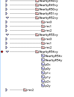

Now that I have 2 waves in each folder; Part 2 of my question is, that I am trying to do a loop for each data folder:
I am using Do/While to go over the number of corresponding folders in main folder "tests", and I use a For Loop for waves in each corresponding folders,
My code does work but only for last folder, "NearbyR54xy". Other folders (such as NearbyR54xy) are empty and have and have no points. (as seen in image attached)
Here is the snippet

Also as you see in code rPxWave1, rPxWave2 and Rwaves1 supposed to give waves with names rr..xToAll, rr..yToAll and RR respectively. I don't know why those waves are not created
jjweimer
Where do you update $WaveNear in the do-while loop? Otherwise, the loop stays in one data folder.
