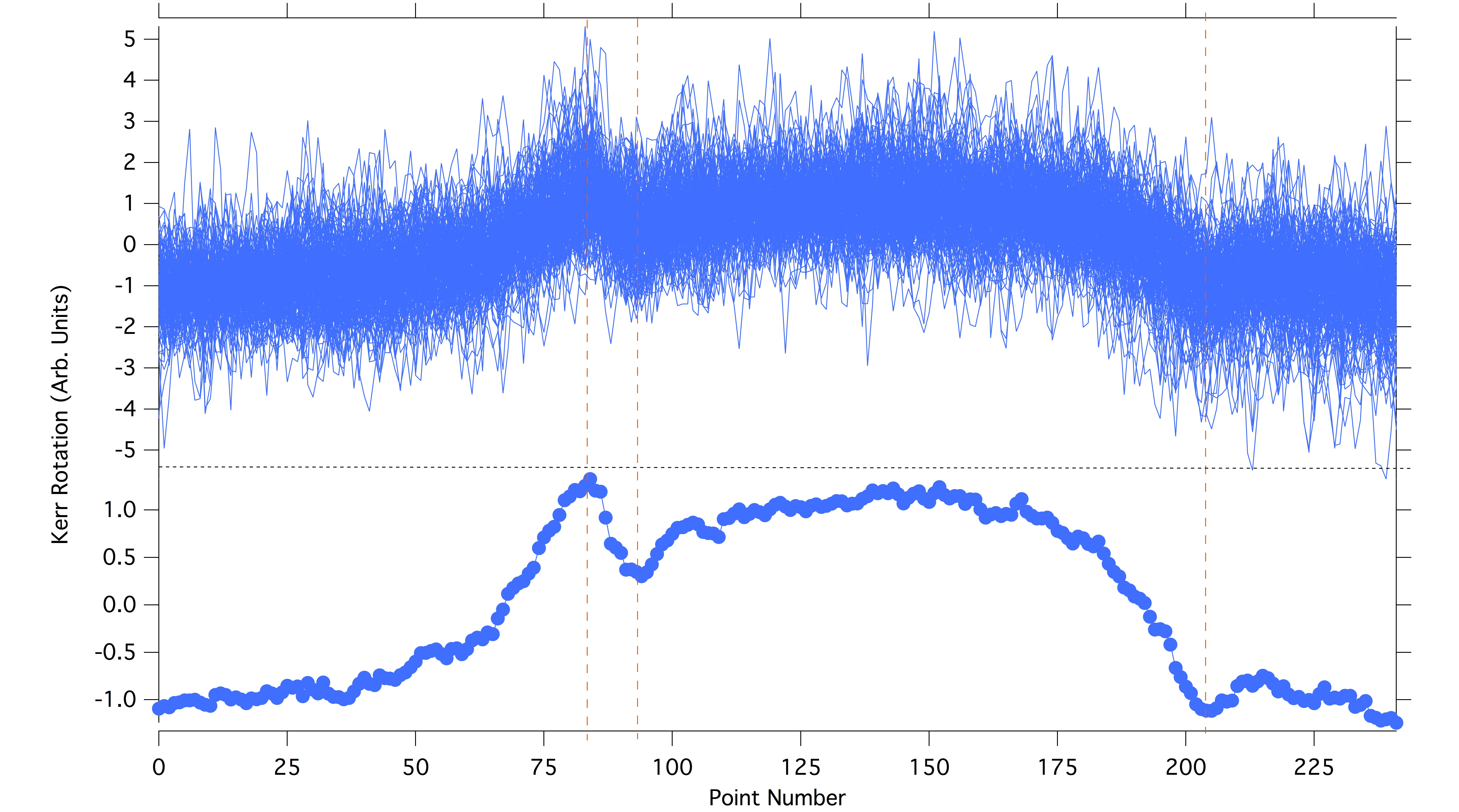

Plotting reversing axis as non-reversing?

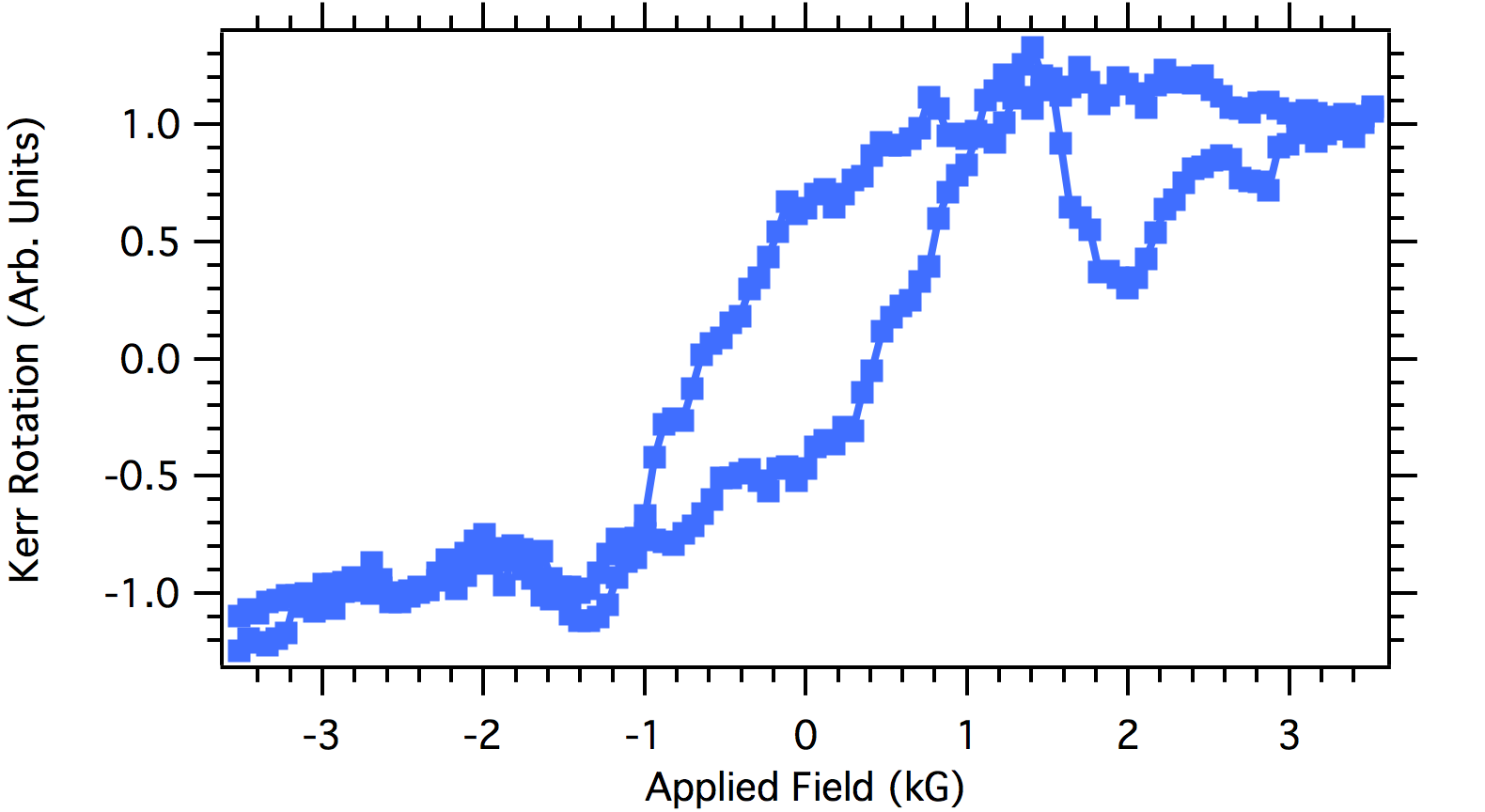

When I plot it vs a reversing field value (-x..x,x..-x) it looks like the second attachment.
Is there a way, without chopping moving and general frustrations to plot a graph that looks like the first image, but the x axis starts at -x, goes to +x, then continues to -x as you move from left to right?
One way to do this:
1. Plot the first subset of data as x (the rising portion)
2. Plot the second subset (declining portion) as x BUT on a new bottom axis.
3. Set the span of the first axis to be 0% to 50%
4. Set the second bottom axis to be50% to 100%
5. Reverse the direction of the second bottom axis
