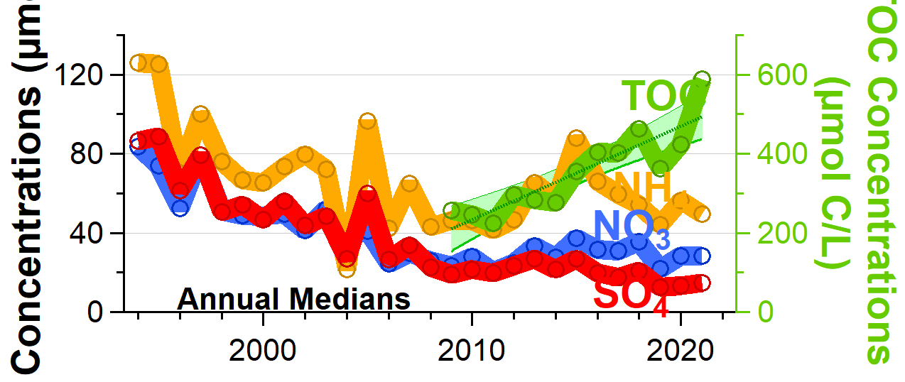

Images are all squished now. See attached example.
November 28, 2022 at 04:12 pm - Permalink
OK, this relates to the physical size of the graphs (i.e., how large they are in terms of cm or inch). I guess you (or somebody else) has manually stretched / shrunk the graphs 'to see them better' on a larger / smaller screen. Unfortunately, there is no way for Igor to tell the size a graph had some way back. You would need to adjust the graph size again to a size of your liking, either by dragging with the mouse or by double-clicking on the white space of the outer frame and then using the Modify Graph settings. I happen to have also build an external package to aid with sizing graphs, which you find here: https://www.wavemetrics.com/node/21562
In general, I would recommend to set up the target physical size at the very beginning and then don't touch the graph's size anymore. You can also lock the size in the Modify Graph dialog or my tool. The desired target size depends on your intended output (e.g., a paper or presentation). You can zoom / magnify graphs without changing their physical size by going to Graph -> Expansion. This will help you to expand / shrink the graphs according to your screen size without affecting their output size.
I agree that it is too easy to 'accidentally' distort graphs in Igor. You have to keep in mind to not resize the graph with the mouse or otherwise, after you have set everything up to look nice in output.
November 28, 2022 at 04:39 pm - Permalink
