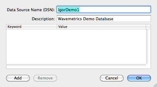

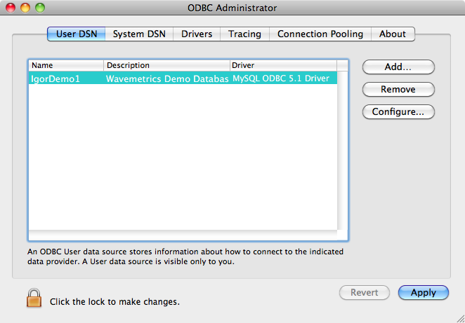

In step 6 I only see the first two fields listed. Do I add the others as keyword pairs? Screen shots attached.
Also I have not found a test button.
This dialog is added by the MySQL Connector. You appear to be getting a generic dialog. Perhaps you should try re-intalling MySQL Connector It looks like the URL for downloading is http://dev.mysql.com/downloads/connector/odbc/.

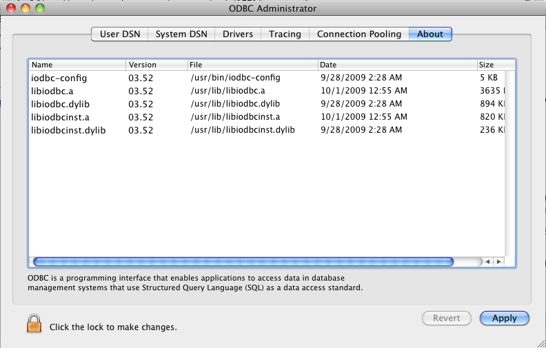

Choosing About ODBC Administrator from the Apple menu shows version 1.1.0. Clicking the About tab shows the information in the second attached screen dump.

In digging around the MySQL site, it appears that I am seeing the correct dialog. The manual may have been written for an earlier version of the connector.

Using the values in the SQLXOP help file as parameter key/value pairs, the demo experiment works as expected. So maybe the documentation will need to be updated.

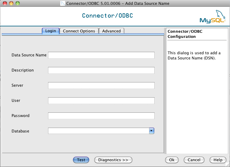

That's possible. I am using ODBC connector 5.1.6. The current version if 5.1.7. The release notes for 5.1.7 do not mention any change to the dialog.
The ODBC documentation shows the barebones dialog that you are seeing.
I downloaded and installed the 5.1.7 ODBC connector for Macintosh and now I also get the barebones dialog. This is true even if I reinstall the 5.1.6 connector. I find this puzzling so I have posted a question to the MySQL forum about it.
