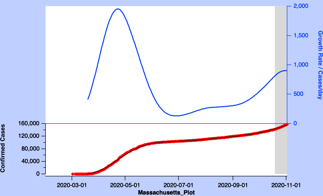

I am trying to draw a rectangle over a portion of a graph. Essentially I want to have different background colors over different ranges of the X-axis in order to delineate different data sources in a graph.
So in SetDrawEnv I set xcoord = bottom and use x values for left/right in DrawRect.
I would like to cover the full height of the plot area, so I use ycoord = prel and 0,1 for top, bottom.
Alas, with standoff enabled on the bottom axis, this only covers the real range of the plot, leaving the portion defined by the standoff clear. I can empirically approximate the desired behavior by extending the rectangle to slightly above 1.00, but it doesn't handle rescaling (e.g. for Layouts) very gracefully.
Is there a deterministic way of knowing the correct coordinate value to cover the full plot range with standoff enabled? Even if the graph is programmatically rescaled into a Layout?

Hi Tony.
I am on Igor 8.04 and I am definitely getting different results based on the standoff setting. See attached examples.
I normally use ProgBack, but I got the same result with UserBack.
The /E and /N flags for the vertical axis also don't seem to make a difference.
Do you see something different when you open the attached sample experiment?
-Andreas

The problem only happens with markers on the plot.
The bottom axis is shifting below the normal plot boundary (y=1, plot relative) to accommodate the markers.
Curiously, if I set the left axis range so that the data are inset, the same thing happens. That seems strange. I haven't looked at the manual to see if it's expected. Maybe contact support (help-contact support). I would expect that plot coordinates should always coincide with the graph background, but they don't if you plot with markers and a standoff.
A work-around might be to plot using a new bottom axis, and make the new bottom axis cross left at some negative value. But then you would have to create the standoff manually by adjusting the left axis range.
November 5, 2020 at 05:03 am - Permalink
@tony The amount of standoff is intended to accommodate the width of a trace. So a lines-between-points trace with a very wide line would have noticeable standoff, too. I have tried to make the standoff account for the width of box and violin plots, also.
@topchem As far as I know, the only solution presently is to turn off standoff, and set the appropriate axis range to inset the data. Turn on the minimum and maximum manual range settings. You can try the "Expand 5%" button to get a small inset.
November 5, 2020 at 09:40 am - Permalink
