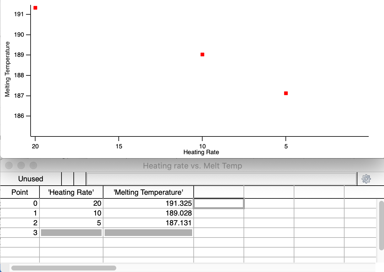

Hi everyone,
I am very new to Igor and analysis programs in general, excel is a challenge for me.
I would like to extrapolate my few data points to zero, that's it.
So if someone can kindly explain it to me in a simple way, I would be eternally grateful.
I know it is a simple question but I tried everything in curve fitting and quick fit to no avail.
And if you have any suggestions for where to start learning Igor and what I need to catch up to its advanced features, I would really appreciate it.

A plot of melting temperature vs heating rate is likely to raise curiosity around here. Do you have some idea of the relationship you expect? Surely not linear.

@Tony It's not a linear relation but I only have these three points so I went with linear. Do you suggest something else?

No, I don't have a suggestion, and I don't know anything about your data - what is being measured and how it is measured, the timescale of the measurements, how the quantities are defined. In short, without knowing something about the chemistry and physics of the process there's not much anyone can say.
