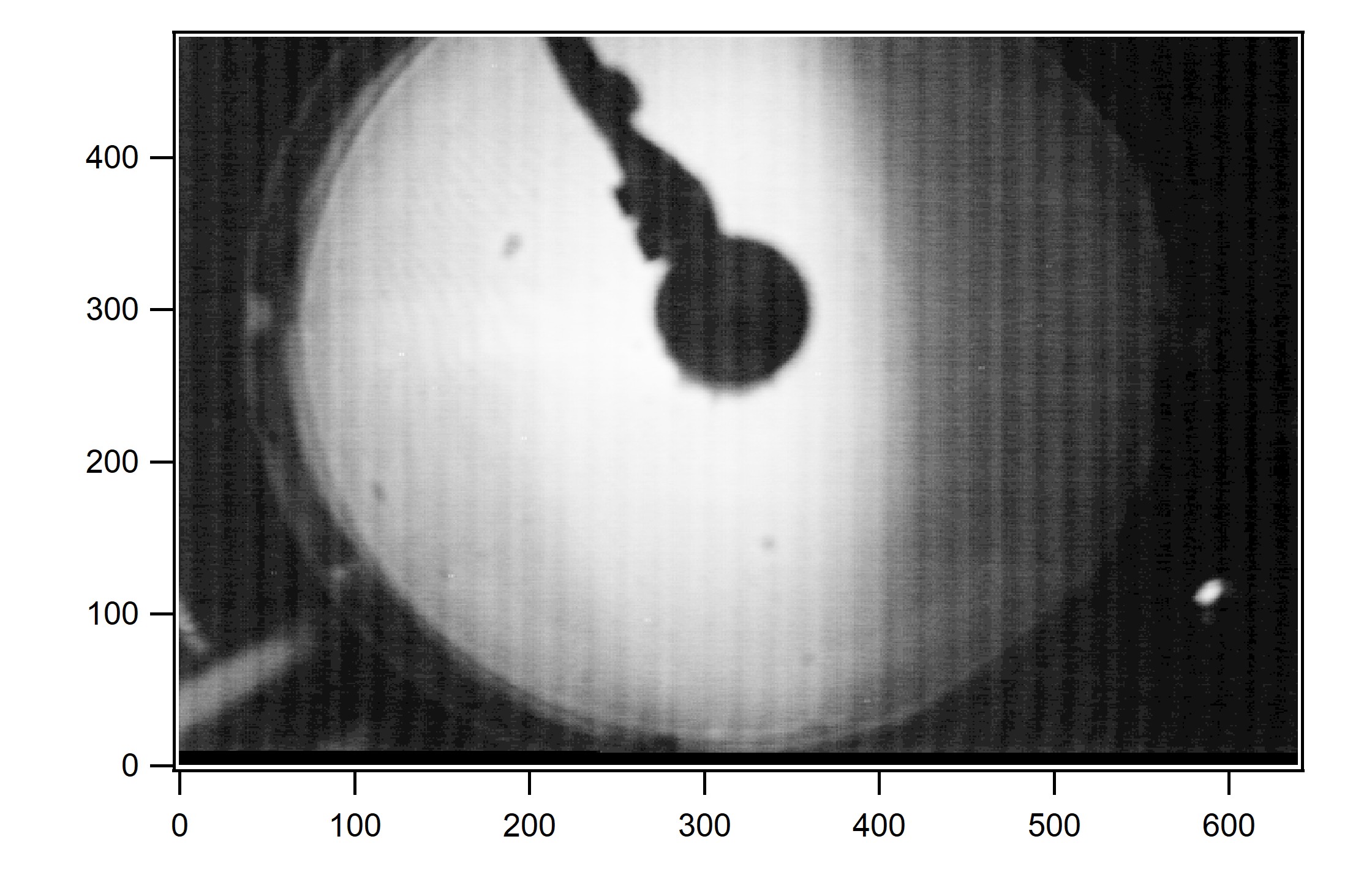

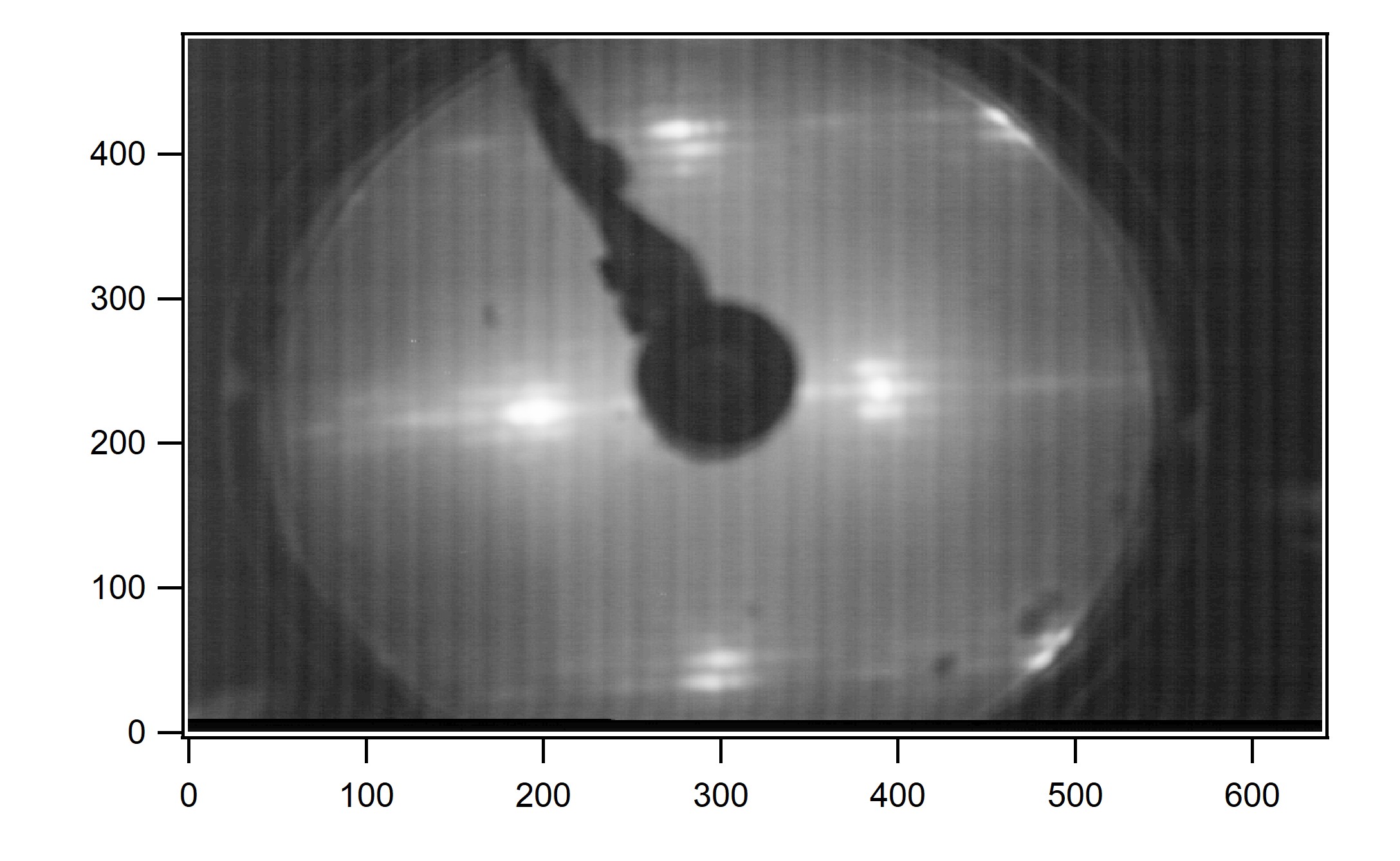

I have attached an LEED image below. I want to know how to remove the background grid lines from this image. But I am not sure how to proceed. Any help?

Dear jjweimer, I tried this but the background image that I have, has an offset and gives a distorted image.
and the intensity is not uniformly distributed among the grids.
